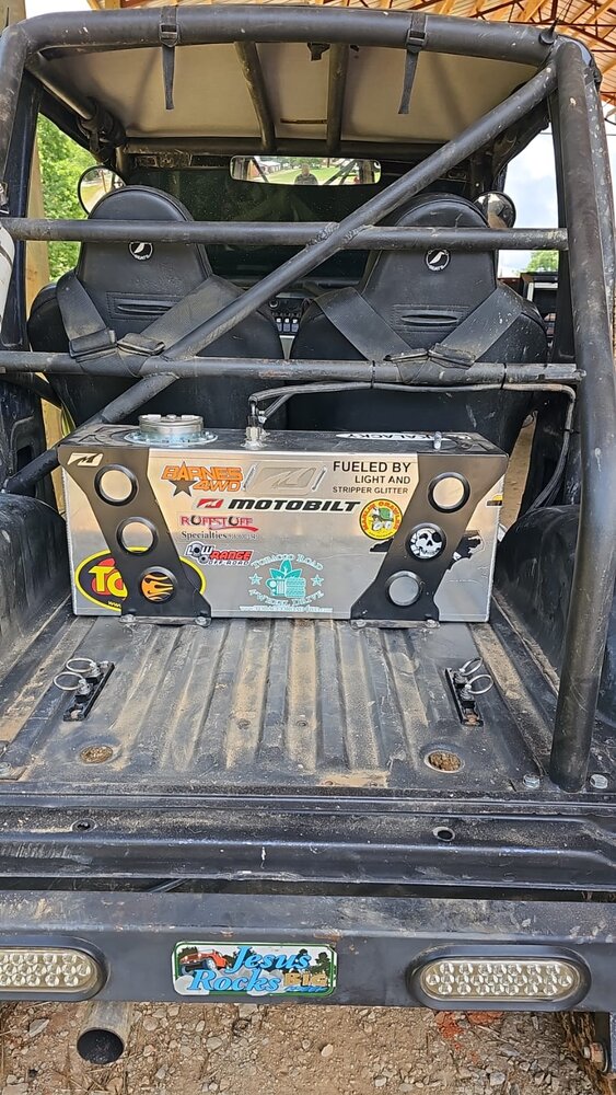

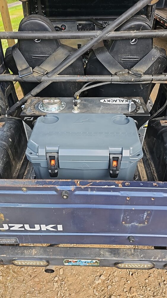

For my old buggy, @MarsFab fabricated a set of studs the cooler sat on that inserted in the feet and had a threaded rod and hook made for the slots with a thumb screw; the threaded rod/hook slid in the slot from the top with lid open and extended down to a tab welded to the tubing. No straps to come loose and it was secure. It could be opened while also solid mounted.
This is the only pic I could find. Iā€™m sure Chris has others. You can see the tab with pins on the tubing beside the fuel cell. No pics of the threaded rod/strap to hold it in place.

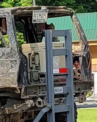

I am not to baller buggy status but for my RTICs I just use the lashing points built in and it has worked great
Not the best picture but we have a continuous loop strap that was used for deer stands, no hooks just one big loop. Cooler is on a tray that the strap can go underneath. It is looped through the cooler tie down slots and under the tray back to itself. Works great.

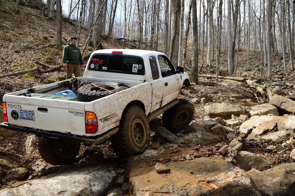

I try to spend the least amount of money possible on this hobby, so I have an igloo playmate cooler ratchet strapped in the bed. I have had this one since 2010, its about to be repurposed into a battery box and replaced with another LOL
