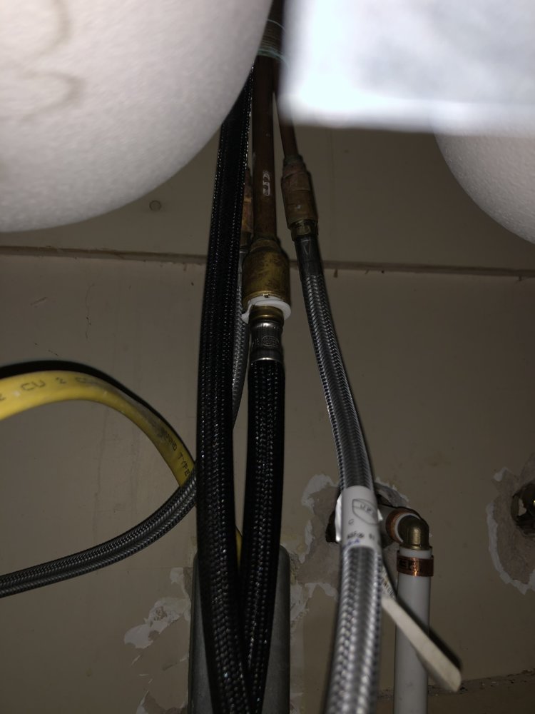

I have a delta kitchen sink with the pull down nozzle (sprayer). Well the hose has a split and I have a new hose to replace it now. I can’t figure out how to disconnect the hose from the faucet. Can some one give me some knowledge? Below is the fitting I am referring to.
If it's like the one I put in recently, there's a special tool. Its kind of like a SharkBite thing that pushes up on teh ring while you pull out.
Finally got it, push up on the white collar and then pull like hell on the hose.
now I can’t get the dang new hose fed back down
