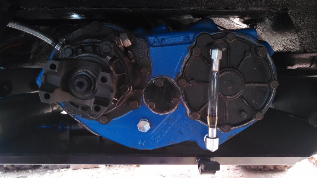

I have my 205 clocked nearly flat and I just don't feel as if the stock fill plug is going to be high enough for continuous use. I plan to add a fill plug to the pto plate and don't want to go more than needed and have oil puking out every seal. The white dot is where the plug is at now.
I put a sight tube on mine and filled it to just below the center line of the front output bearing. It was clocked up similarly to yours.
Yep. Used bottom right drain plug for a 90 degree barbed fitting for a sight tube. Mine holds exactly 3 quarts of Amsoil. I fill through sight tube (hydrostatic pressure)

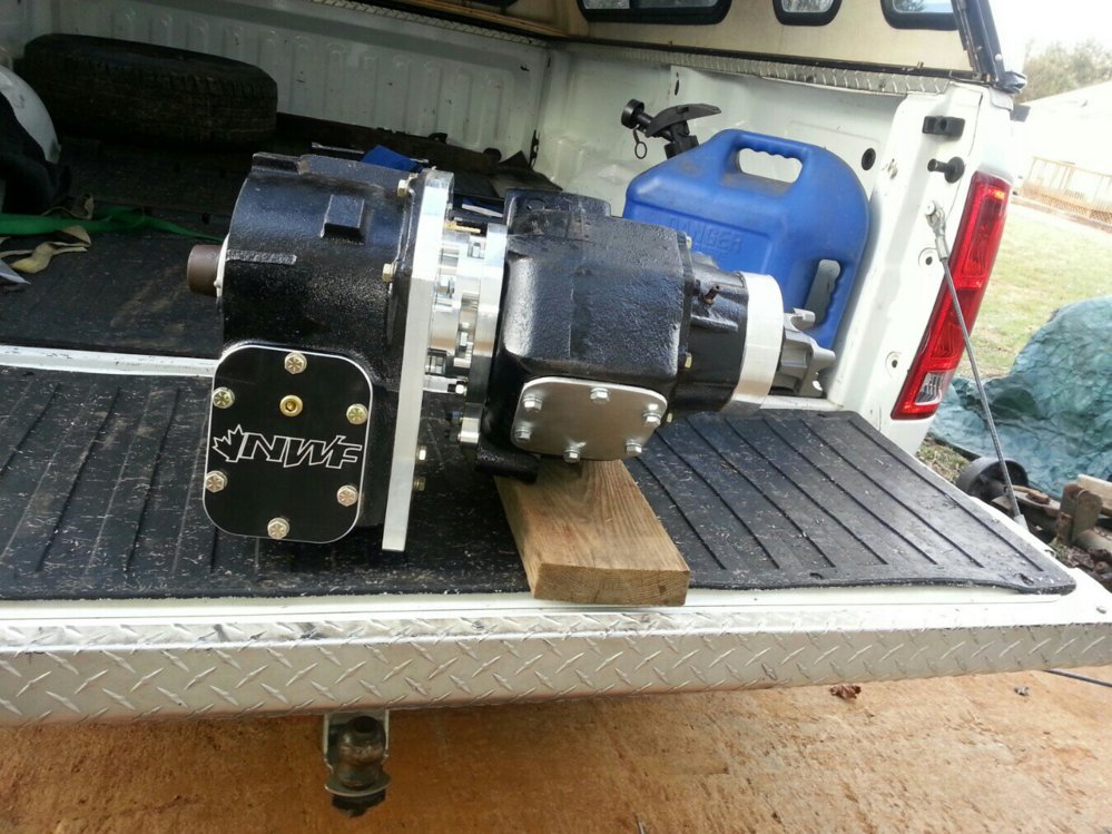

I went the no b.s. route and used a northwest fab doubler kit.
