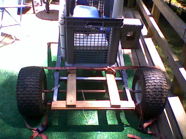

..building a surf fishing cart out of an old custom tree stand and 15/6/6 front tires off a riding mower. Are these tires big enough to roll about 100 lbs. in the sugar sand ? I'm going to install the axle to balance it where it pulls easy loaded. The back end under the cooler squats 4-5" off the deck w a cross member when It's tipped a bit as I think it will be while I pull it . It would be easy to add some blocks and longer u -bolts and I'm tempted to raise it just to get the cooler higher. I'm thinking 2" :smokin:

the front tires read 15 6 6, but they measure 13.5" dia. and 5.5" across the tread. The $200 store carts I've seen have that size on them.
I've seen guys at the coast with anything from thin bicycle tires to, what look like, balloon tires. If you're gonna lift it anyways, I would go ahead and put on the wider tires. Like said above, flotation is key. While the ones on there may work, the wider ones will work better when you add 50lbs of fish :smokin:
I gonna drill holes in the 5/8 steel rod axle and use cotter or hitch pin clips and washers to locate the wheels on the axle.
I think the axle size is the same for front/rear so I suppose I could drill 6 holes to mount either wheel as I also suppose the hubs are different lengths.

I might take it to Jordan lake for testin, I think they have a beach there. I was talking to my 74 yo dad who said it needs to have a seat and be able to drag him up and down the beach. The front wheel hubs have a smooth sleeve, the rear wheels have a key way but I assume they will roll pretty easy w some moly grease.
Gonna run w the smaller tires and no lift. I have $20 in parts and think it will work for this trip, only about 100 yrds to the beach. I know it will roll easily on the flat/tide sand and I found if I pump the tires past their rated pressure they get round across the tread. I'm pretty sure that alone will make them roll over sugar sand easier. I'll post some finished pics soon.

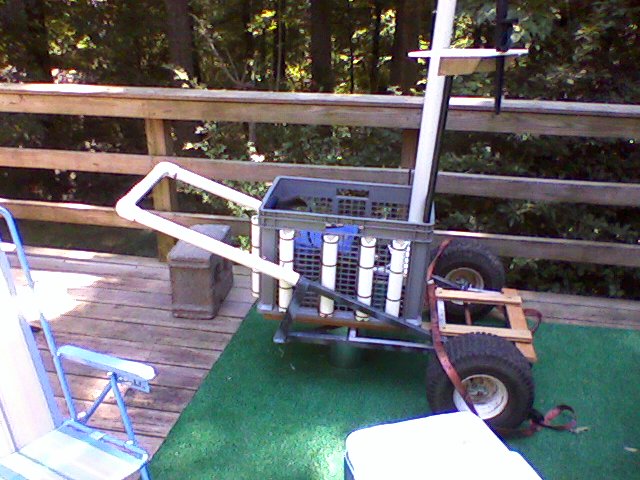

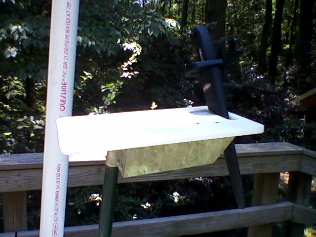

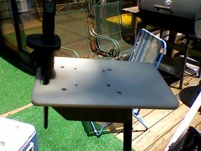

Almost done w it.......made a bait cuttin station out of a pooper scooper shovel, going to rig holders for the pvc sand spikes...........

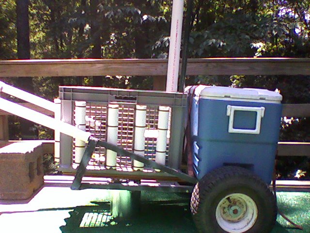

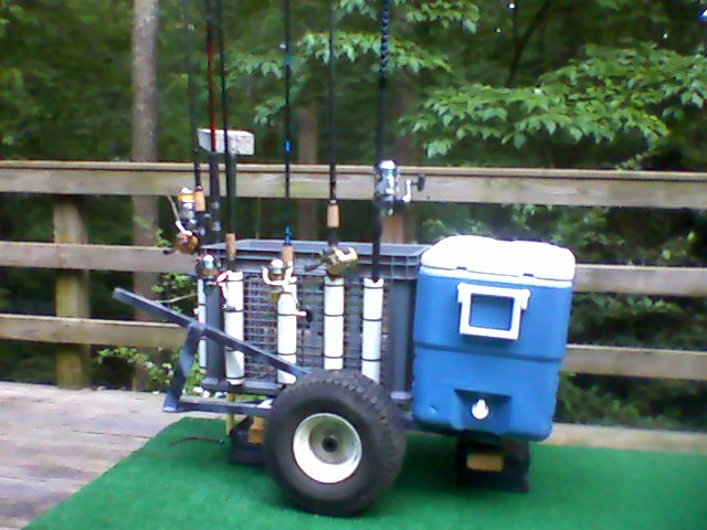

the cinderblock was in the cooler to help w locating the axle so the 1 1/4 pvc handle has about no weight on it when lifting and dragging it...........next week I'll post pics @ the beach, hopefully some fish pics too!
