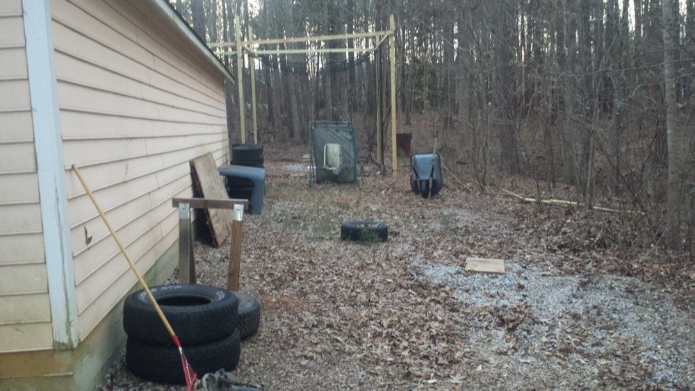

My wife gave me the preliminary go ahead for building a carport off the back of my workshop at the house. Our camper is currently sitting in a portable garage beside my workshop and she finds it extremely unattractive, and she is kind of right, so I convinced her that I can build a carport behind the shop that goes the full length that can store the camper and one of my cars. I think I have the design figured out, but I'm wondering the best way to set the posts. Should I anchor them 2-3 in the ground and just cement them in, or should I set concrete piers and then anchor the posts to the top? The car port is going to be big, probably 15-20' wide and about 40' long.
Going to go back here.

Yeah, that's what I'm thinking. 5 posts on the right side there. Put a 2x12 header attached to the side of the shop, five 4x4 anchored in concrete on the right side, 2x10 joists and then throw some corrugated roof on it.

I'll probably do five 6x6 along the right side then, it'll be about 8' tall on the end. I think going to gravel at the bottom of the hole and then concreting them in. That was my initial thought, but I've never built something other than a fence that was in ground. Well, maybe the batting cage in the background of that pic, but those are just graveled in.
