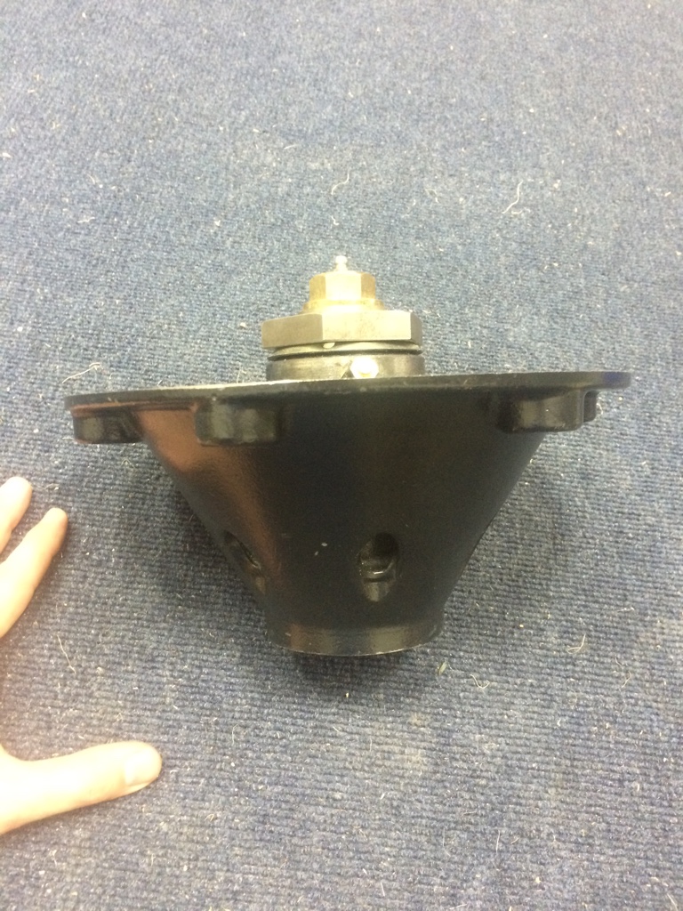

So our client asked if we could figure out how to cut a cross section of a spindle they make. Damn thing is about the size of a quick change differential. Made of cast iron and has bearings inside some forged and machines steel parts.

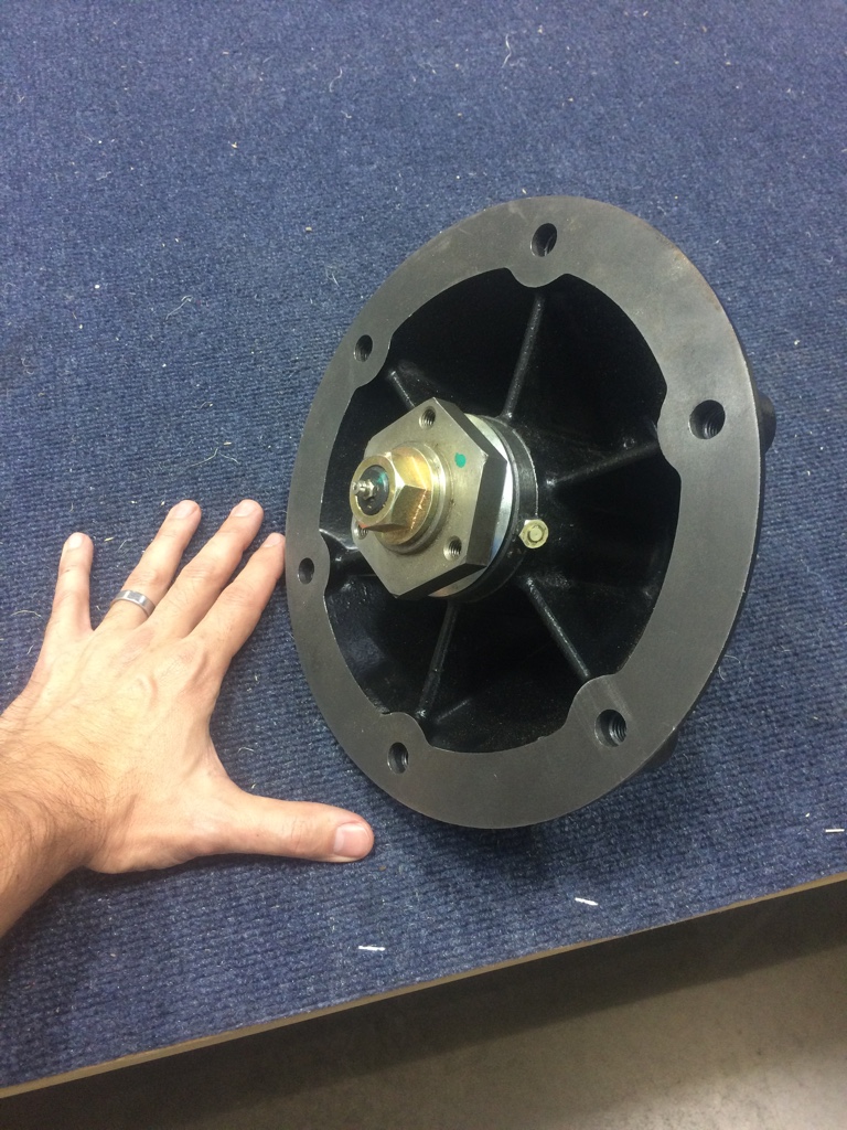

Here's a picture with my hand for size reference.
Any thoughts on how too? I'm guessing it need to be machined in parts and reassembled?
