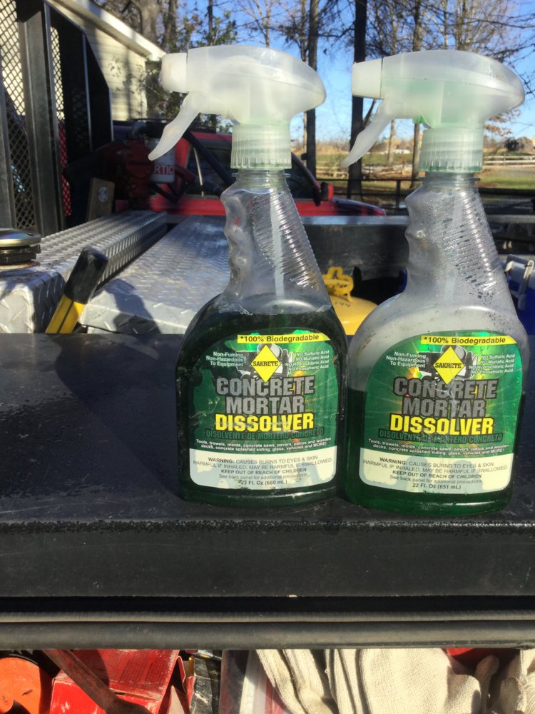

Matt, I have a couple bottles in my truck of a product we use at work. It may be what you saw at the local stores. We order it by the case. Be glad to give you a bottle to try. I’ve had good results with it but does take longer to really do anything on older concrete. If the splatter has been on that thing a while not sure how effective it will be.
That's what they show online at Lowesdepot but nobody stocks it in store. If you happen to be in the Steele Creek area or out by my house, I'd love to try it.
We use some of that green stuff. Works well enough. On older stuff kinda only does a layer at a time. Wash scrub rinse. Wash scrub rinse. Slow goings but we try to stay on top of it. Paint seems fine
Got you covered.
