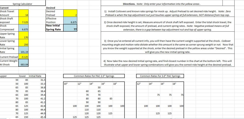

I created an excel file for calculating current spring rate and new desired spring rate.
This is to make lives easier getting the correct springs for your rig.

Now that I understand most (80%) of the theory, I feel like I keep posting this stuff. Created the excel file today while nursing my hangover.....
@karatejosh If you get me your current spring rates and how much of shock shaft is showing at ride height, ill see what your rates should be at 2" preload. I know you are zero preload now, and it may not be possible to get light enough springs, but im curious what the results will be.

It worked for me, but I think that cell b8 should changed to an IF statement =IF(B6>0,(B6*B7)/(B6+B7),B7). That way you can install 1 know spring and get the corner weight, and use that to determine to correct preloaded combination.
