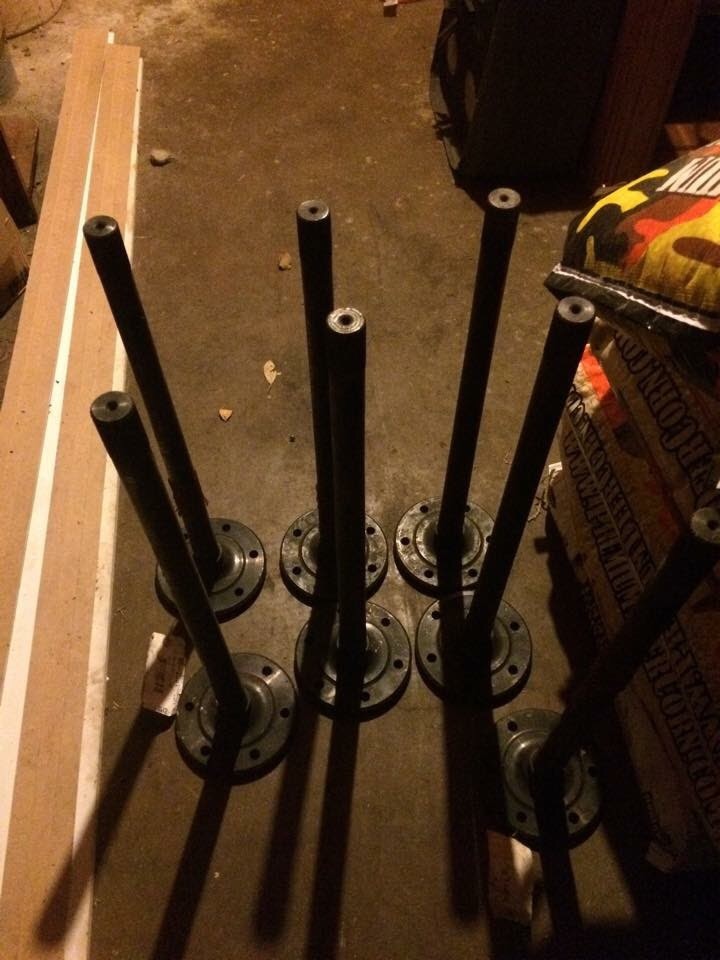

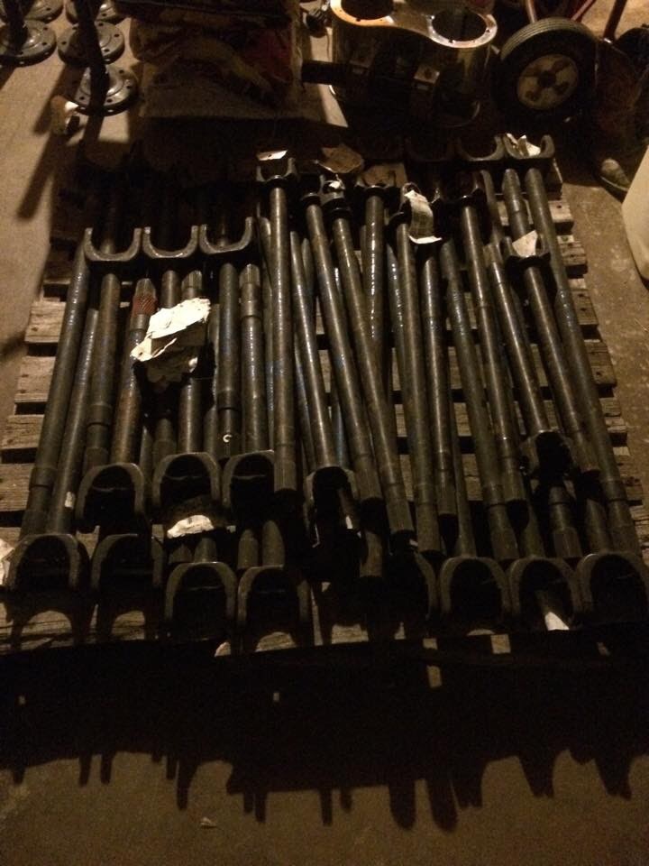

I was on Facebook and found a guy selling "G2 Chromoly 35 spline inner axle shafts for a 78/79 Ford axle."
How do I verify that I am getting actual chromo's or something else?
See his pics
Should say 4340 on the ears.
I thought that too, but every image that is online at retailers doesn't have anything stamped.
They look like G2 shafts, but just not sure if I trust that they are chromoly.

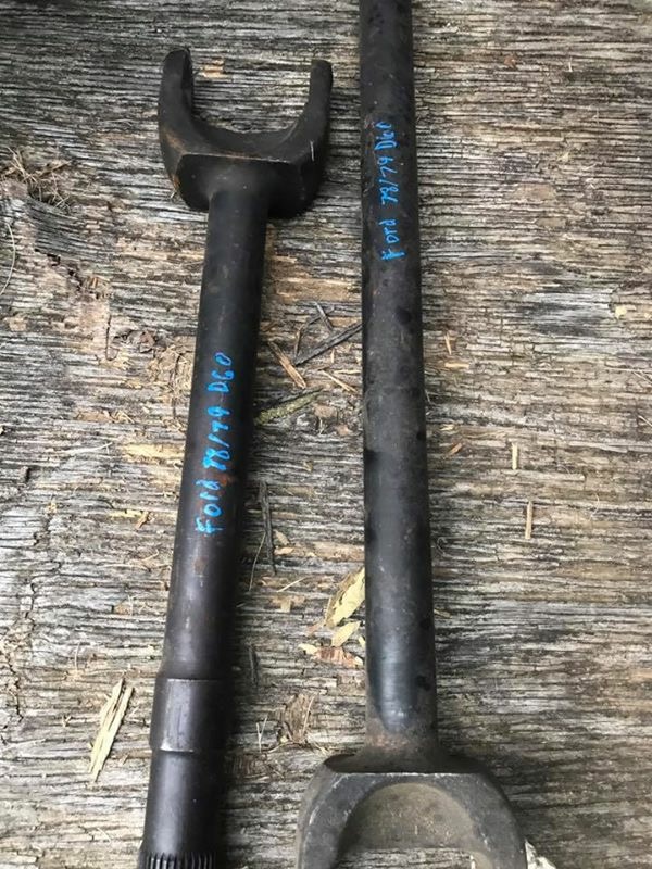

I'd also verify lengths with what you need. We rode all over Harlan and hazard county ky one night to buy a chromo 60 shaft, and it ended up being a mix of shortened inners and ford stubs, that the guy advertised as chevys.

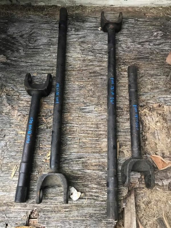

Yep, $200 shipped for them. Both inners. Verified length already.
I thought most ChroMo stuff didn't have the raised seal surface. It'd be same dia. full length???? Either way, good price for full spare set.
This.
I have never seen "chromo" shafts with a raised surface like that.
I'd be quite careful if it were me.

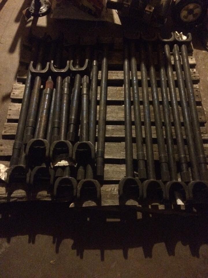

So, I talked to the guy on the phone.
He was actually pretty nice and seemed like a good guy.
Said that he bought out an off-road shop a little while back and a bunch of shafts were in the shop on a pallet.

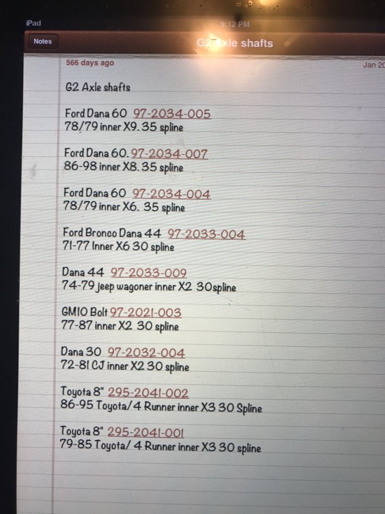

He said this is a list of everything he has. He is trying to sell them all if anyone is interested. His name is Cody and his number is (817) 888-5103
It is kind of weird that almost every website that sells these Dana 60 Shafts says that they are chromoly.
Then the G2 website says they are 1541H steel.
Are they still stronger than stock and worth $200?

Those ain't chromo's, they're 1541H but they are G2. G2 AXLE & GEAR | HOME
The other thing is G2 doesn't make chromo shafts for the Ford 44, just the TJ/JK 44's.
@Jody Treadway @Mac5005

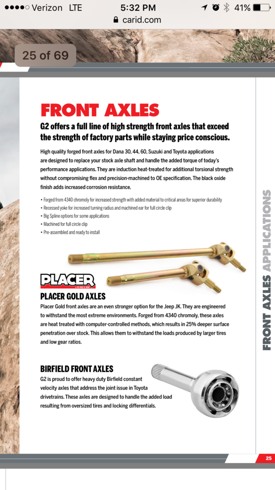

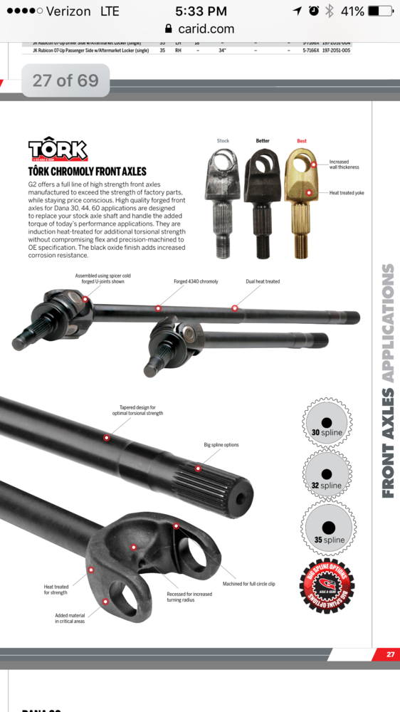

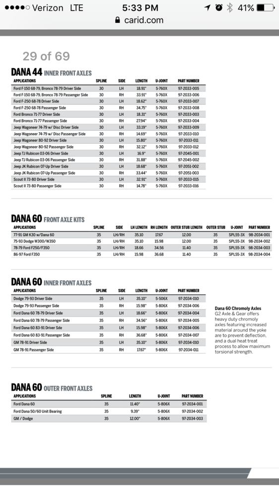

Called G2 and the tech guy said that the part number I have them (97-2034-004/5) was actually 4340 Chromoly.
He said their rear shafts are all 1541H
I told him what the website read and he said it was wrong and that he was reading from their catalog. I asked for a copy and he said he was not able to send me that...
:confused:
Looks like the catalog says 4340 Chromoly
