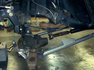

Hp 44 8 lug TJ swap
WARRIORWELDING
Owner opperator Of WarriorWelding LLC.
Jan 6, 2008
Chillin, Hwy 64 Mocksville NC
Progress on a project TJ. Consist of 60 rear 44 front Rubi 4.5 lift and custom steering using 1 ton tre's and 1 high steer arm.
PICT0030.jpg[/ATTACH]
what track bar drop bracket is that??
customer supplied parts, go ahead and bash it to for not being hardcore enough.... should do for a daily driver though!:rolleyes:
Yes its an RE and their stuff is always spot on for no brainer put it together and get it done. Not everyone wants shop fab everything and daily drivers don't usualy fit this catagory. By the way all the axle brackets are RE with allittle tweaking and they've been skillfully removed from one bad low pinion housing and applied to this one.
o don't get me wrong RE is good stuff.. just when i installed i was short on funds so for scrap steal we just made a bracket.
