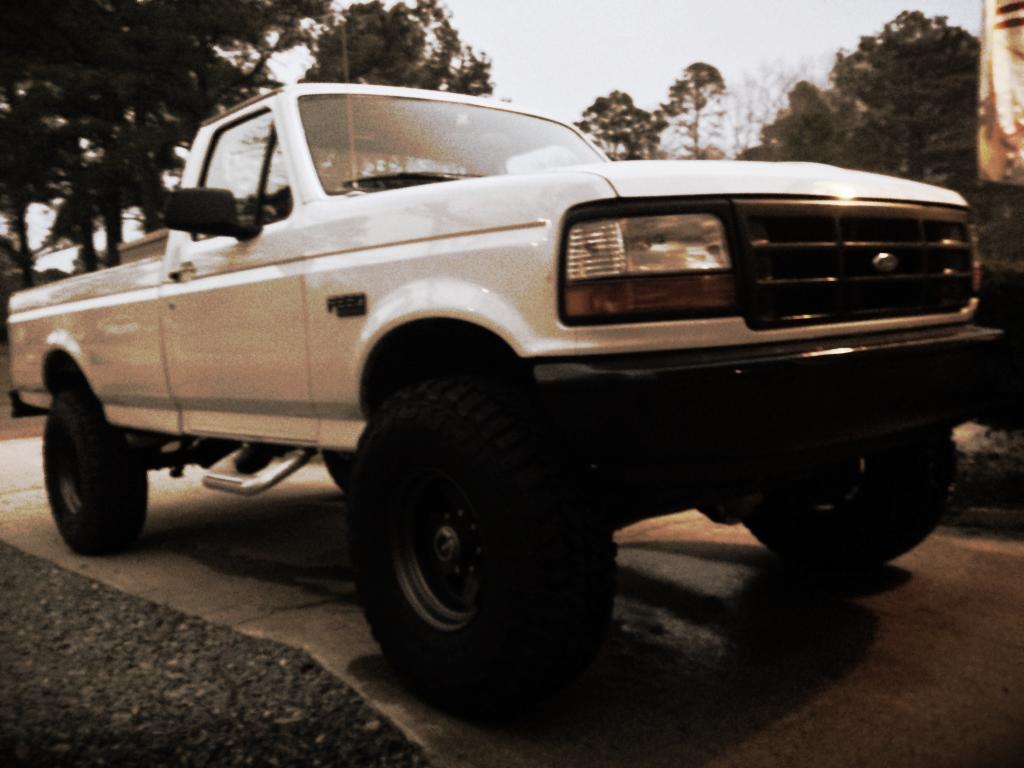

I am considering changing my wheels to hummer wheels (already running Hummer MTRs). I like the look and this would allow me to change tires easily at home. It also would let me have one spare between the truck and the M1101 trailer. I would need spacers, I am dubious of spacers. If I buy steel 3" wheel spacers would they be ok? I guess stress wise they are no different that wheel offset on bearings and as long as they are high quality and the nuts stay tight they work ok.... what do you guys think? Remember this truck is not a rock crawler and 3000 lbs is about the max trailer I will tow with it and that is less than a 400 lb tongue weight.
This is on my F350 BTW

Why not just recenter the wheels? There are a dozen companies that make flat centers and a few that make quality pressed centers. You'll end up spending more, but then you won't have to drive around knowing that you've got 3" spacers under there, waiting to cause problems. Plus the option to have "custom" wheels for not a whole lot of $$$ has to be appealing.
Do the recenter option now, then down the road add a rock ring, etc. and really dress that thing up.
I would just find 3 more wheels like I already have for the trailer and spare before I did that.
The appeal is the look and already having Hummer wheels on the trailer.
Spacers versus recentering the wheels makes no difference as far as forces on the hub. Only disadvantage of spacers is 2 sets of lugs. I say go for it. If I redo the axles in my TJ at some point, I plan to run H1 wheels with dually hubs or wheel spacers.
X2. I recently had this setup on my truck. I figured, I could always sell the spacers and recenter later if I choose, but cant remove the center and go to spacers. Plus I figure that the factory was able to produce a truer wheel center than I could weld one in.
You just need to break back out the 5x4.5-8x6.5 spacers

That would put me at 5" BS, Need to measure but most folks who do this get 3" spacers. My tires are at least 2" outside of fender now with 3.5" BS so it would be good to get them back inside the fender.
You are in the same boat I am. I think end result is to use the HMMWV rims if you are OK with the downsides like lengthy tire changes (which don't really occur often) and added weight. I personally would rather run DRW hubs than spacers if you can find them. You may even be able to track someone down looking to do a swap with you.
That would do nothing for the rear unless I am misunderstanding. Isn't the actual axle (rear) what is wider on a dually?
a DRW hubs is basically a cast steel spacer. It bolts to the SRW hub/rotor and has new studs pressed in. Also they are closer to 4-5" spacer.
