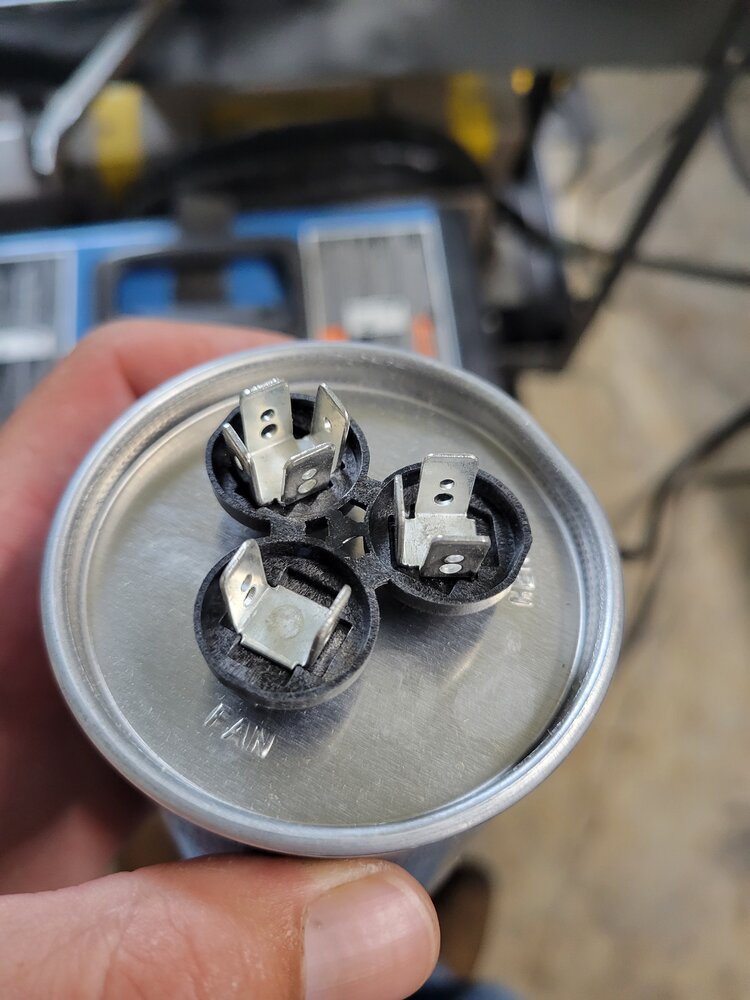

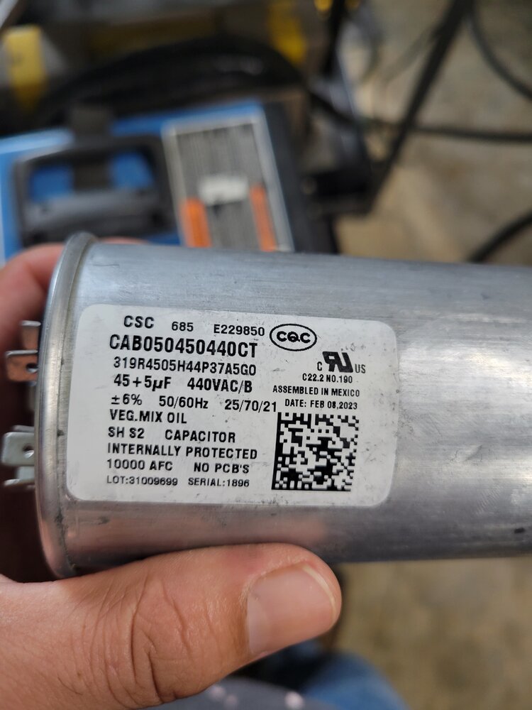

HVAC cap
Life hack.
Figure out which ones you need order spares from Amazon keep in closet,
Another cal will never pop again
I ordered one from Amazon and had it same day. I have an extra one if it'll work you're welcome to it.
