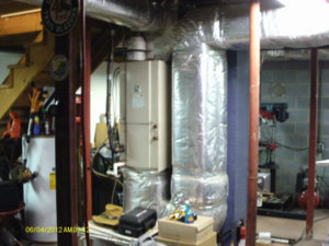

It's a ranch on a basement. The location I'd like to put it is almost directly above the return box and close to the center of the house. Moving it here would cut about 30' off the return line. I'd be getting rid of this:
http://i.minus.com/jbizZWRFm2LMfE.jpg
And moving it here:
http://i.minus.com/jbr7ASTBFWQyYR.jpg
All plumbing, wiring, and the flexible send would be moved to make room and make sure I can seal it completely. It will span two joists. The grate will straddle the one visible to the right of the flex line. Alternately, I'd be happy to box out the area with 2x10s so I could drop an actual return box under the floor and eliminate the panning altogether. I tried to get a pic of the monstrosity that is currently the return line taking up space in my house. It looks like the escape chute for when the mothership lands.
http://i.minus.com/jH94OtyJNljqo.jpg
That tube would go almost straight up to the new location if I go this route. I couldn't find another suitable location. All closet space (what little there is in this house) is needed, and any of those would make it more cumbersome in the basement.
