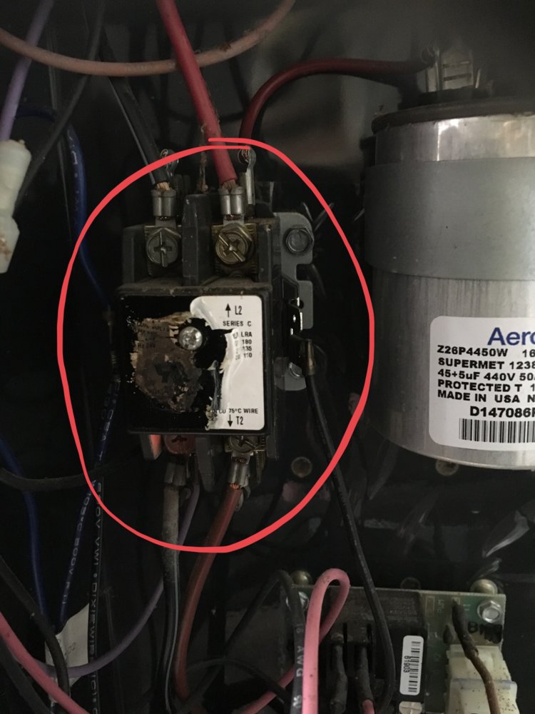

HVAC peeps- what is this part?
Deplorable
Feb 13, 2017
Asheville
And more importantly, are there different part numbers?
So, outdoor unit gets the signal and won’t come on. Tap this block and a few sparks later, the outdoor unit fires right up! No professional here, but seems like I should replace this and hopefully fix the problem...
Wasn't being smart. Hope you didn't take it that way. A local man who did Concrete got killed working on his AC. Be safe.
Not at all. Thanks for the warning.
I’m always extra careful around electricity. That’s why I used the screwdriver handle to gently tap it...

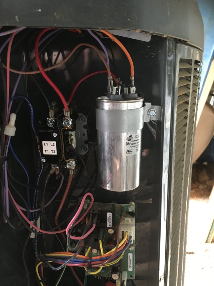

Was your 24v from the xformer good? Could be just a shitty contactor because those are about the cheapest out there or it could be a low control voltage issue or possibly the compressor pulling a lot of amps for lots of reasons.
possibly the compressor pulling a lot of amps because the cap was bad
That's where my head was. I can test a cap with a meter, but for $20, might as well swap it out. But to your point, a bad contactor can be its own problem, or it can be a symptom of a different problem.
ANd to further chicken or egg it...a failing (shorting) compressor will stress and take out a cap. A new cap or an upsized one may mask the issue and limp you along for a bit...
