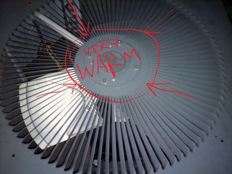

OOH OOH OOH!!! I just figured it out. LOL
I turned the unit on (I had turned it off a little while ago because it wasn't acting right (cooling)...) and went outside. While it was running inside, the outside unit was not, but I could hear the fan motor trying to run. :(
So my fiance turned the unit off while I was outside, and I heard the fan motor switch off...no more electrical "buzz" from the motor. Also, the panel where the fan motor attaches was very warm. Calling the Home Warranty folks tomorrow...
So do you all suggest I call the Home Warranty people (which should have a service charge of $65..."Trade Service Fee") or call the local A/C repair shop?
See how much the fan costs. It's mounted by the four screws you have circled in your pic. If you can change an alternator on a small block chevy you can change that fan. There is a name plate (sticker) on it with the model number and info you'll need to buy another one. If that part of the unit is getting hot it's most likely because the fan is trying to run but is locked up or a bearing is seized and it can't turn, so it builds heat.
