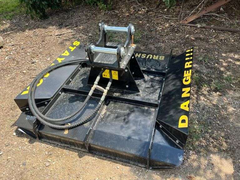

Is that cutter rated for high flow? I've never actually seen a high flow brush cutter and I've used several including a few from C.A. . I'd run it on low
The sticker they put on it says it is and I paid extra for high flow, but after my interactions with them I have little faith in anything they say or do.
well the picture uploaded a little blurry, but the big white sticker on it says 27-40gpm

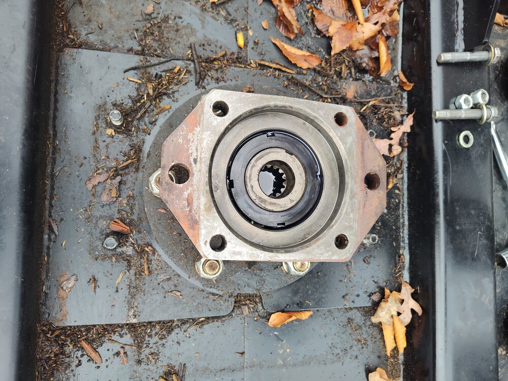

Well I made a big mistake, evidently I struggle with reading comprehension. My original motor is a knock off of a Char-Lynn 6000 with the exception that dynamic offers a 1.250" 14 tooth splined shaft and Char-Lynn only has a 1.5" 17 tooth splined output shaft. Through all this I was looking at the diagram for my dynamic model number and didn't realize it was 1 letter off and had a custom sized output shaft.
What do y'all think my options are here? I don't really want to have to buy another one from dynamic but it seems pulling the output shaft out of the new motor and having it machined down is about my only option if I keep it. Here is a pic of what it mounts to. I looked up the manufacturer of the bearing housing hoping they offered a shaft for it that would accept the new shaft but they do not.

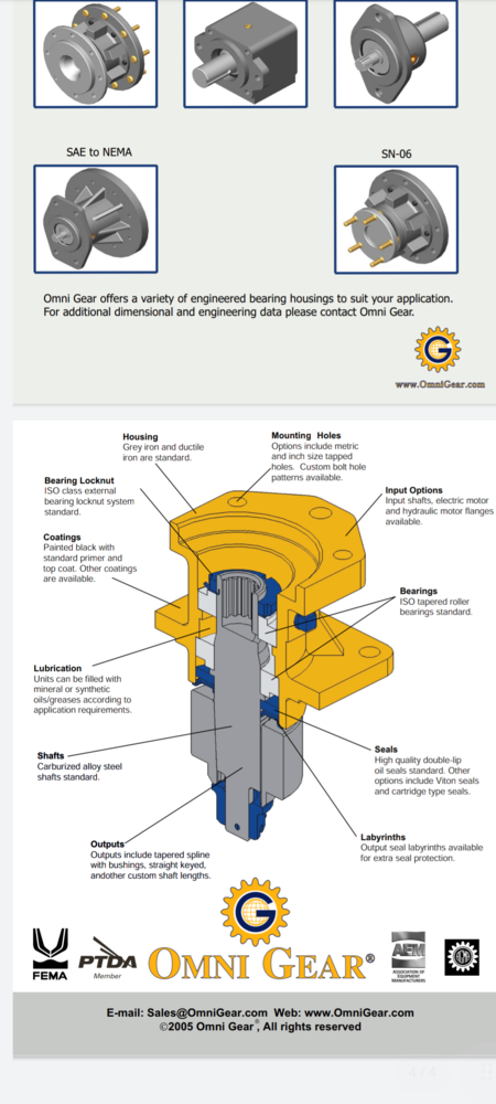

Got any more pictures or a breakdown of hoe they did the blade carrier/spindle? If it can be wire edm'd rather than ram edmd I can get it done for nothing. It's almost like they found some surplus motors or something, dynamic doesn't even list 1.25 14 as an option for bmk 6 series...
Dynamic has a note at the bottom of the bmk6 catalog page that says custom output shafts available. The spindle is a Omni gear mdh65
I think they did the 1.25 shafts because they use a bmt motor for the low flow cutters and they have a 1.25 shaft. I'm guessing this allowed them to source a high flow motor without redesigning anything else on the cutter.

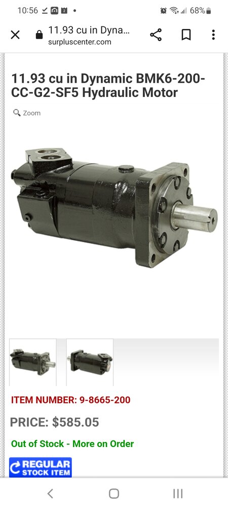

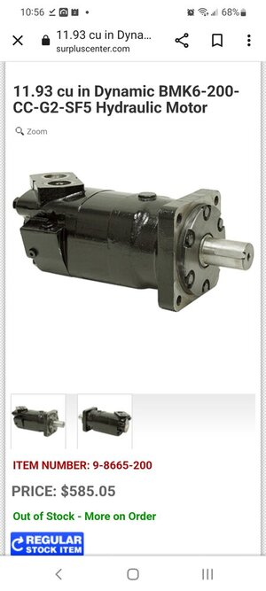

Now that I reread thread I see the confusion and different part numbers. This is actually an easy fix, buy a new bmk6-200-cc-(fe or g2 or t1 or y1)-sf5 for the best price you can find, pull the front plate off and swap output shafts.
Surplus center "has them on order" for $585.
Dammit man, that's the solution!

I love you, simplest solution staring me right in the face. Thanks man

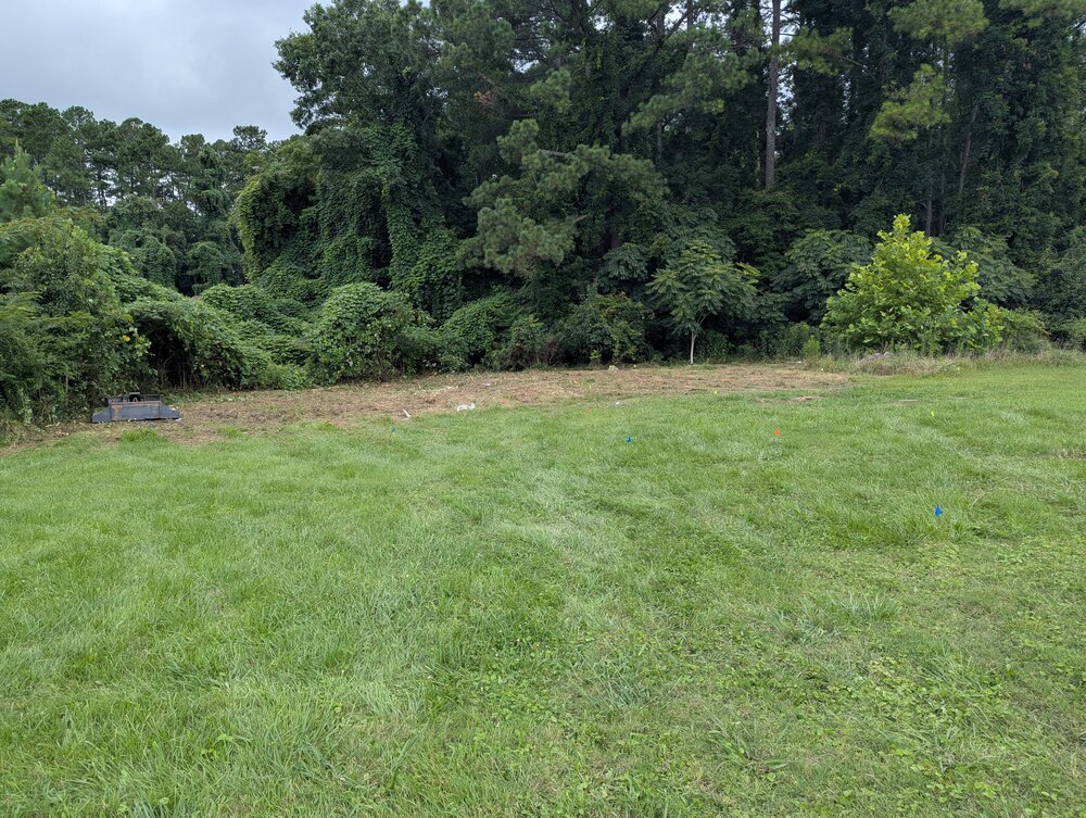

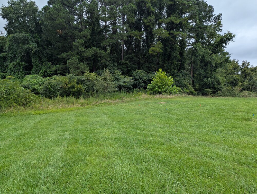

Im wondering if the check valve , they call it an H valve, is causing issues? What say our resident experts? Below is a before and after photo of what I was cutting and a picture of an "h" valve setup, like I have.
