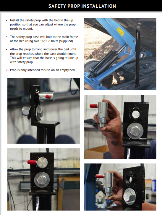

I would recommend a prop that goes between the bed and the frame so the cylinders can be removed if needed. The one on my truck is a piece of 2x2" 1/4" wall square tubing. It came with the kit, and is pinned on to the bed with a slick spring loaded 1/4 turn cam style release.
