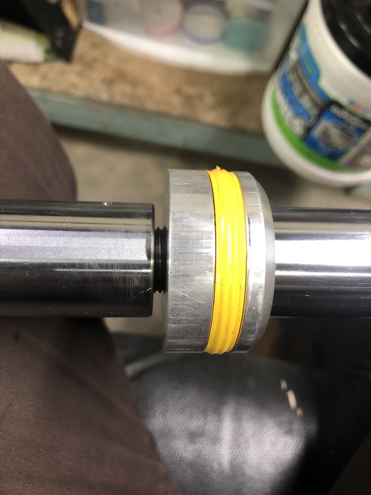

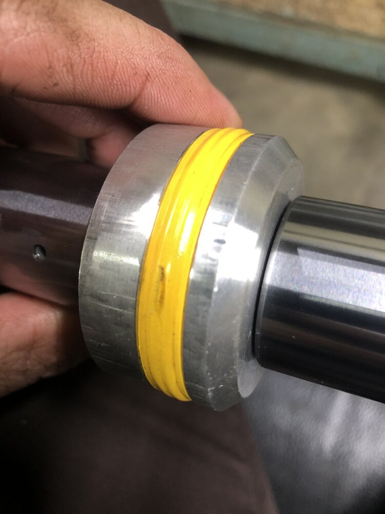

The steering still didnā€™t want to go full lock with the engine running. I ended up taking apart the ram and found this. The piston could move/tilt and I assume is was letting fluid past the seal to the other side of the cylinder.
I went by Rotary Drill Service in Newton and they had the seals in stock. Hopefully this fixes my steering
