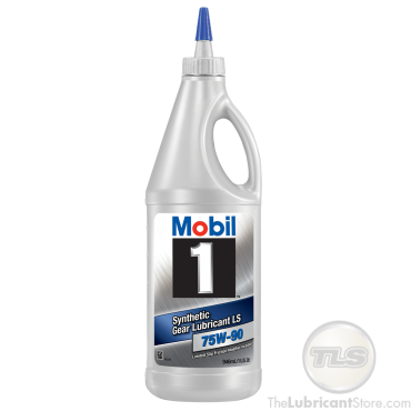

Here's what I (mistakenly) used:
athelubricantstore.com_media_catalog_product_cache_2_image_37085effc2370ca1ad1523ccd25751e7ce5.png

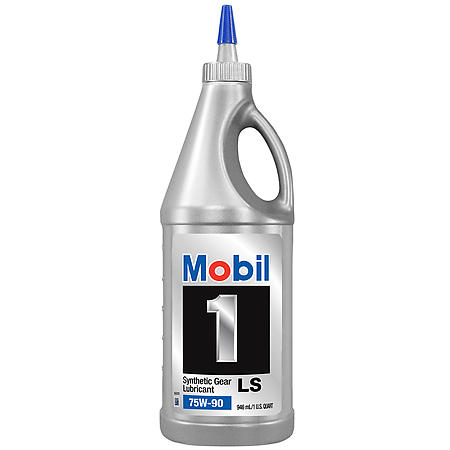

Yeah, I know, looking at it now, it's really obvious that it's for limited slips (Synthetic Gear Lubricant LS) but, honestly, I looked at the bottles ten times before I noticed the LS. Heck, I didn't even notice the "Limited Slip Friction Modifier Included" line until this morning, that's some tiny subtle print there! (still somehow noticed that small print well before I noticed the LS (looked at it three more times and didn't notice the LS, DOH!!!!)) They used to make the LS a LOT more obvious, like this (the biggest print on the bottle other than the brand!):

For what it's worth that's the only synthetic they make now and the bottle states it for standard and limited slip diffs. Also says you can add additional additive.
