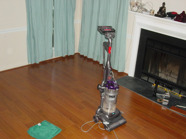

Anyway, we bought some laminate flooring on clearance a couple of weeks ago and finally was able to tackle it last night. Don't knock the baseboards, when I took the happy snaps, we hadn't recaulked and painted them yet.
looks good, hope you like it. i hate how loud ours is when the dogs are walking around...that clicking is the bane of my existence. btw, how do you like the dyson? i've never used one.
The dyson is awesome, that was the wife's Christmas present and it has some suction, so much that when using the attachments, it's hard to pull the hose.

Are they individual "plank" strips?
Laminate flooring has really coem a long way in the last few years.
I like the highlighted "seams".

Floor looks good. Hope you left room for expansion!
Yep, just like the directions said, 1/4".

Yes, planks that snap together.
good job. how long did it take?
Once we started, it was between 4-6 hours. Reading and understanding what the directions actually wanted was the hardest part. We also did a good bit of reading on diynetwork and hgtv sites prior to even buying the stuff.

It really is a cinch, you just gotta be prepared for different situations. It helps to know a few tricks, such as shaving the locking mech. and adding glue, when you cant tilt the board to snap it in. Like at the end of a row, when there is a door jamb to land under. Most of the newer stuff will allow you to snap a whole row together, end to end, then attatch as a entire row. This makes it fast. Good , fast $$ for the pros.
