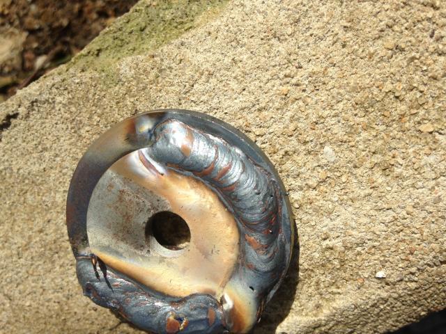

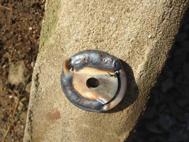

The side of these washers closer to the center was done with the .024, the other side (second pic) was with .035. Notice the thinner but much better bead on the first pic. These are small washers, the added control and smaller bead is a HUGE plus.
ai7.photobucket.com_albums_y252_ponykilr_21BEFC67_EF1E_4153_AE66_416748D2EDFA_zpsbgxrxnwi.jpg
ai7.photobucket.com_albums_y252_ponykilr_D6A55426_935A_401C_93A0_3027E2BB29C4_zpsfziuajii.jpg

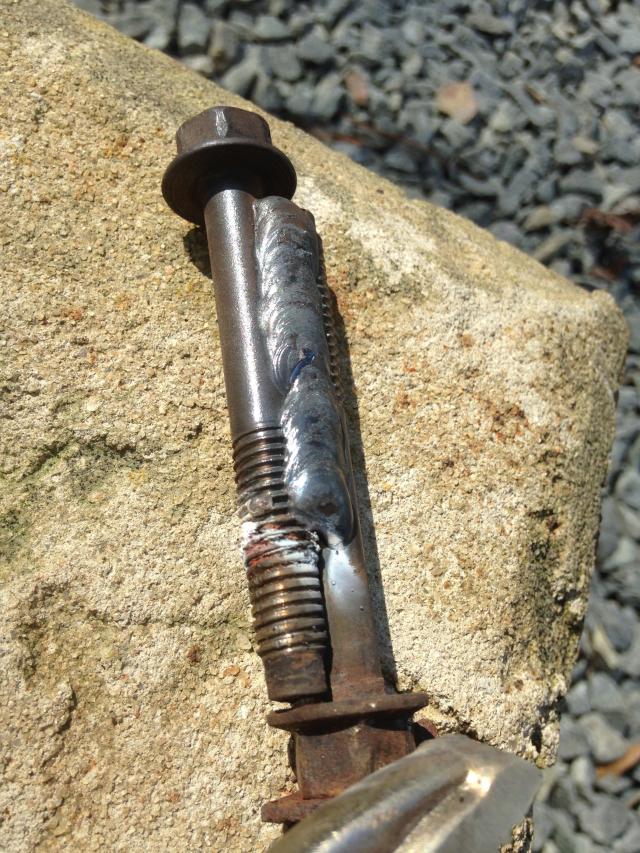

These old bolts did well, a spark hit my bare arm and you can see where I jerked LOL
ai7.photobucket.com_albums_y252_ponykilr_43380131_FE97_462D_9B5F_85268F27DC65_zpspgbxghxa.jpg
Grind off the galvanizing and your welds will look even prettier! Your arms will thank you, too. As will your lungs and guts. ;) If you're still flinching when you get a lump of molten steel in your elbow crease, you need more practice! Kidding. I like it when they fall down your shoes. I had a big one burn into a tight thermal tee I was wearing the other day. It rolled around to the other side of my elbow and left a big red streak before it burned its way out!

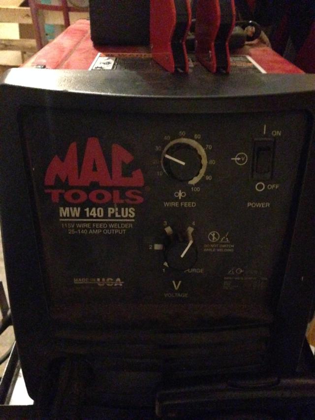

When I had the heat on 3 and the wire speed around 45 it was magic. Heat on 2 and around 30 wire speed was great too. I welded up a hole on a Flowmaster muffler where a bracket had been welded to it and ripped off. Worked well on 2 for that.
Welder is a Mac I have had a long time, I think Hobart made it but I am not 100%.
ai7.photobucket.com_albums_y252_ponykilr_FDBD0EBC_8E91_443B_B462_E93D24D82A82_zpsicxyh6ic.jpg
Another tip is to take a sharpie and wrote your common setting that weld well inside the machine cover for each wire size and type.
Reminds me what to start the settings on when I change wire.

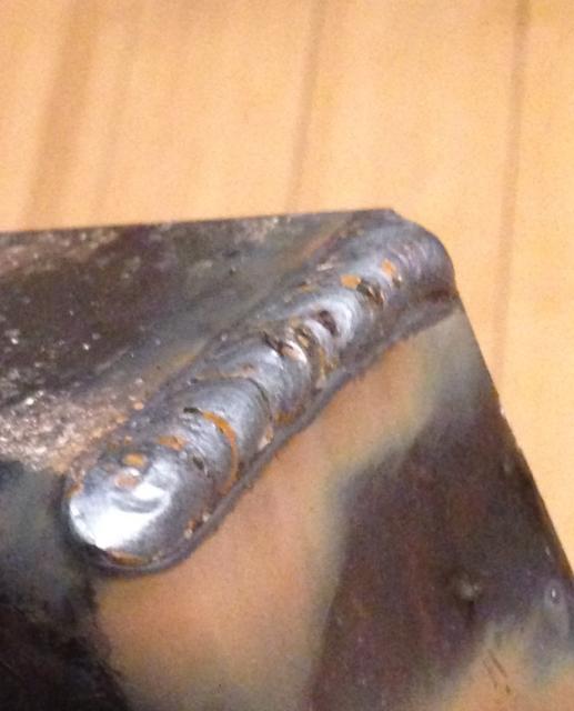

Here is a little outside corner on some scrap 1/16 plate.
Other than the little bit of contamination, do you see any obvious problems Mac?
ai7.photobucket.com_albums_y252_ponykilr_D46AC593_D897_46CD_8C93_BE46E1269823_zpsp0lndv3u.jpg
That looks pretty damn good!

Not too bad at all.
Cleanliness is everything,
Next is clarity of seeing the weld pool, and next is being comfortable while making the weld.
After these are set, any defects or fusion problems are east to fix.
These will lead to consistency and great looking welds.
Also listening to weld is very important. Keep the sound the same as you manipulate the puddle. This will keep your amperage consistent.
No spits, sputters or pops anywhere in your weave.
Practice moving through the weld before you squeeze the trigger to make sure you are comfortable, and practice a similar weld on a scrap piece to understand how to change your weave for each piece and position.
A good time to make sure you settings are good for that situation.
