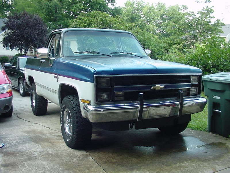

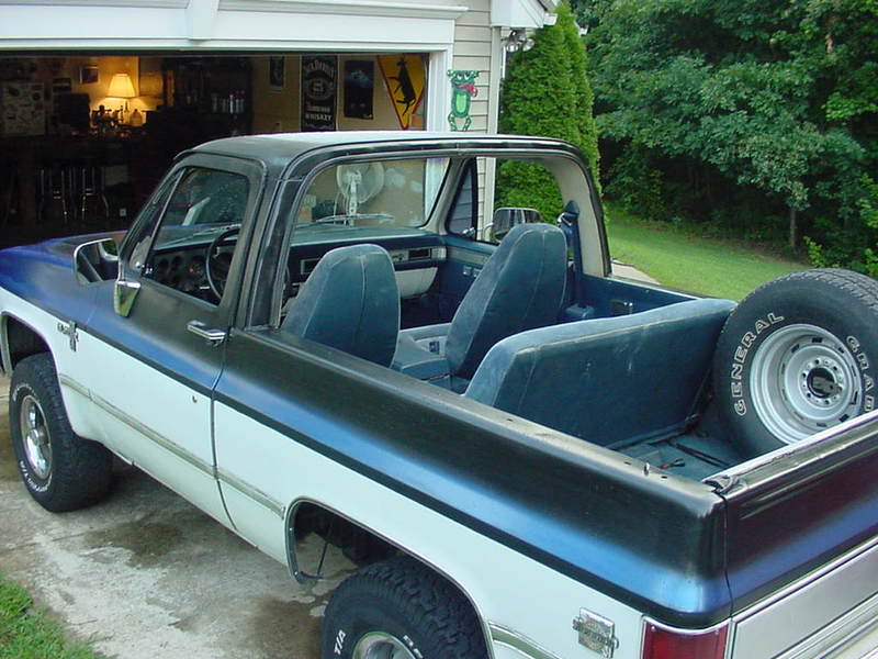

I got a K5 blazer!
My header flange gasket is blown out so it sounds really loud! :D

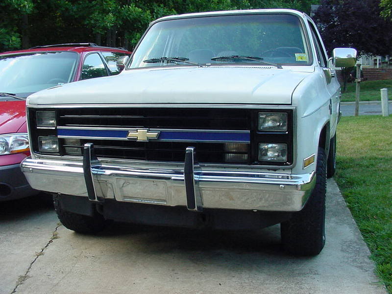

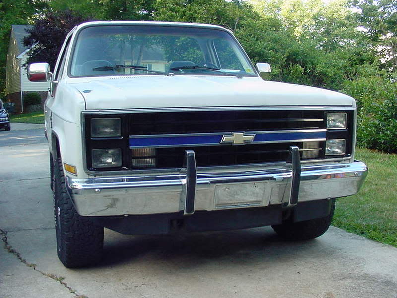

Painted the grill black and blue...:beer:
I spent about 30 seconds trying to figure out what color it was and how the shadows were playing tricks on me. Then i figured out you truly lived up to your name, even outdid yourself with the rattlecan fade.
LOL...thanks man! Taking spraypaint to a whole new level! :D
:beer:
I'm sure that will happen sooner or later. LOL :D

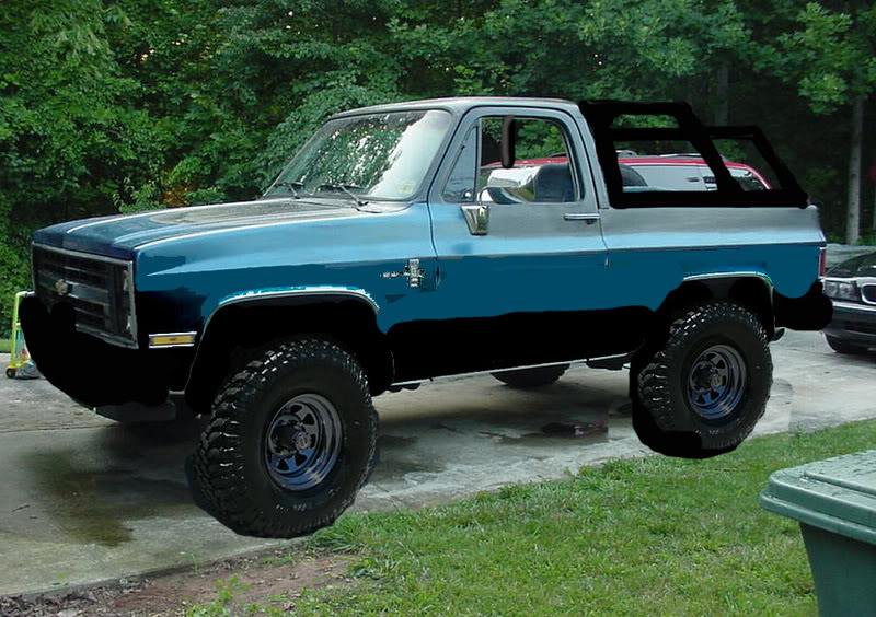

It's all black and blue now! :D LOL...looks a lot better. The white just wasn't doing it for me.
like this...
actual picture...

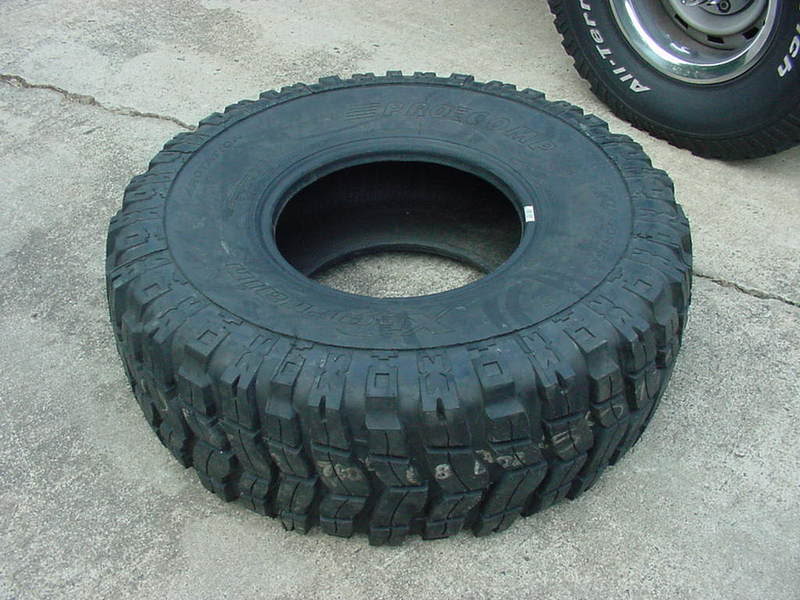

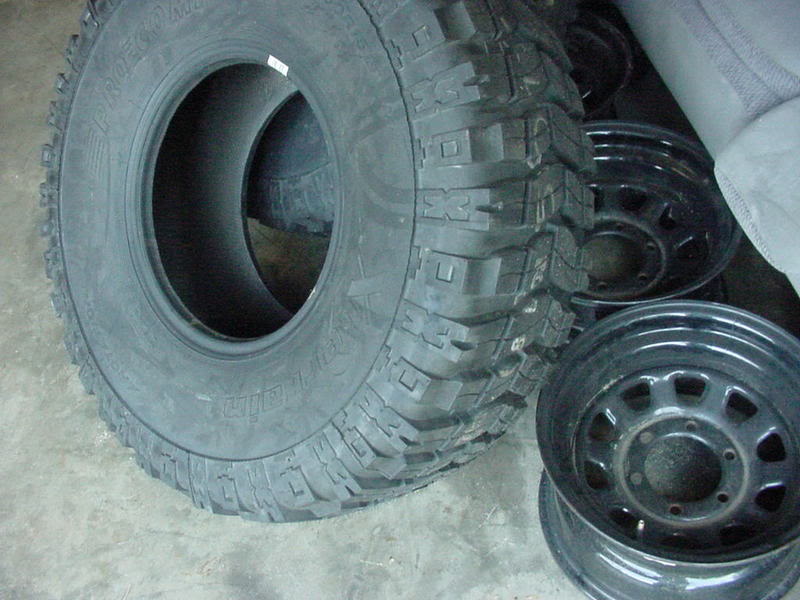

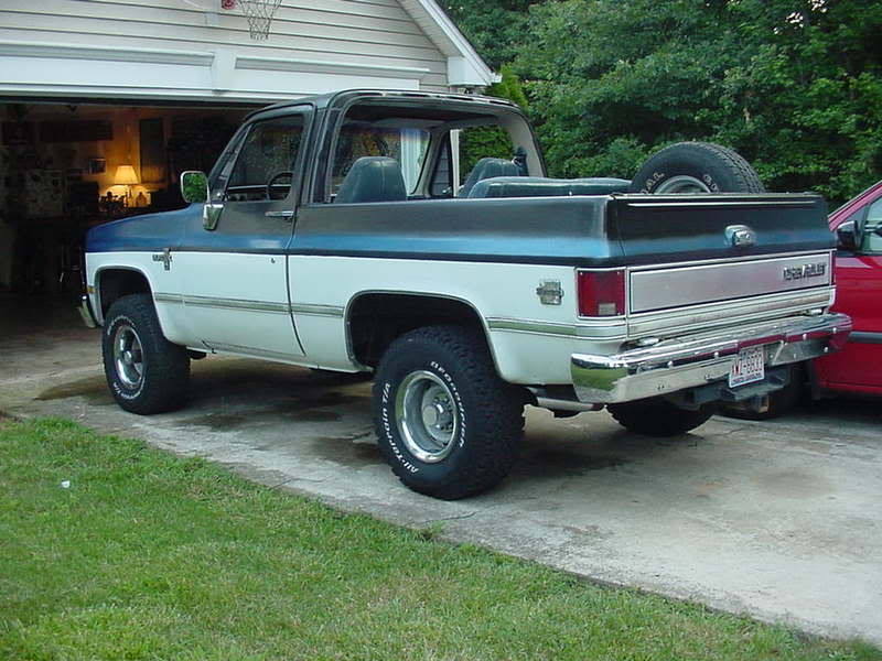

new tires too...
40" tires and 10 bolts will be just fine! :D
Thanks guys...now I just need to get the new tires all mounted up and get started on the roll cage!:beer:

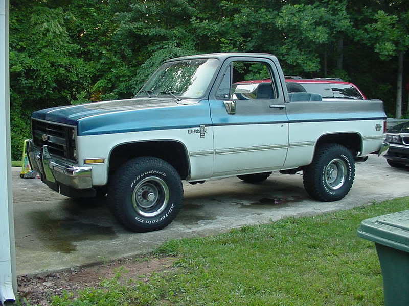

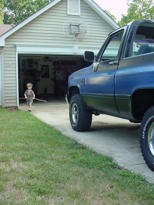

Got the tires mounted to the wheels last night. Used shampoo and a few pry bars. Also added 8-10oz of air soft pellets in each tire to balance the tires.
It was pretty easy getting the first bead to pop onto the rim by just pushing on it. Set the wheel on the ground and then set the tire on top of it and lean real hard! LOL
Then came the hard part getting the front bead of the tire onto the rim. I had to stand on the tire with both feet. Get an edge to go under the rim first and then stick a prybar in there to get the rest of the tire under the wheel lip. Gradually getting the tire on the wheel using two pry bars and then finally it would pop on all the way.
Added the air soft pellets and aired them up until the bead seated on the wheel and set to desired pressure.

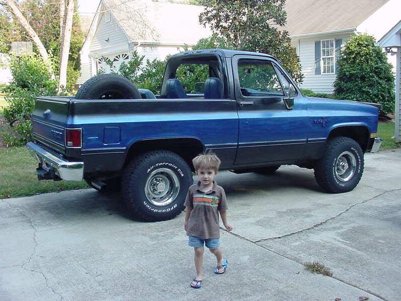

Mounted up the tires on one side with the stock suspension to see if they fit. The front will need some trimming of the fender and maybe a little on the back wheel well.
