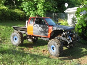

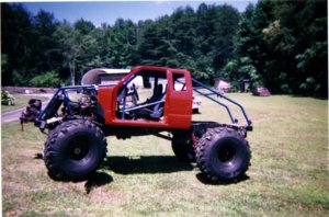

this is what it started as 84 full size chevy short wheel base 87 s10 cab 350,4 speed 208 and stock tons greared 456.

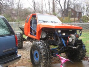

after a cage and some bondo
fresh coat of paint.

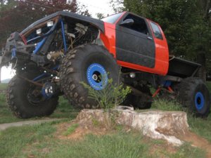

after getting water in the motor it was time to cover it up and change the cage a little. No room for part's and not enough weight in the back I put a bed on it. also put a 205 case in crossover steering with hyd asist,propane,air and 35spline outers detroit locker's front and rear.

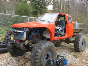

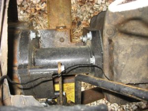

bought a turbo 400/203/205 off the board and wanted to keep my 4 speed so with a little scrap and a cnc mill i had a adpter made.
brandon at rides give my front end a face lift. new cooling unit and a grill for bling bling.

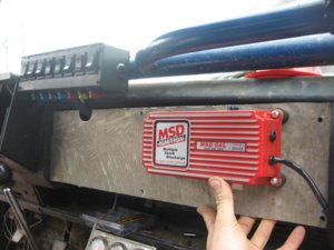

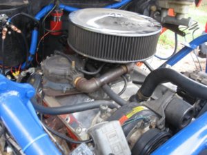

another motor this one I have a little money in new from oil pan up. mild cam,msd,billit dis,and painless wireing (which was a pain in the back side)

Hell yeh man, looks good! I dig a cab truck. You should consider moving the radiator to the rear and pushing your winch back, right up in front of the motor to shorten the overhang on the front end. The custom tranny/TC adapter looks good.
