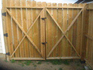

I built one last summer, used 4x4 post spaced 8ft apart, 6x6s in the corners. only used concrete for the cornerposts. I laid the 2x4s sideways horizontal instead of vertical for a little extra strength. The gate was the fun part. I also painted the bottom of the posts that would be underground with black tar so moisture wouldnt rot them off. IIRC it ended up being roughly 170 linear feet, turned out nice though. Heres a couple pics, hope this helps
