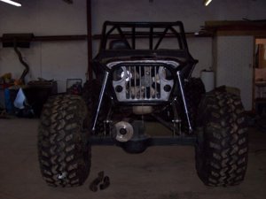

hopefully im gonna come out at about 15000 on mine . ive probally got about 1000 more to finish. i think thats cheap for what ive built
