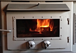

As I sit here by my wood stove with it's beautiful flames from the oak inside, I feel so bad for my brethren who heat by other means.....
ai7.photobucket.com_albums_y252_ponykilr_Woodstove_5fb99ecb_8c1805ee0d979c3423b8db48c57f52dde6.jpg
