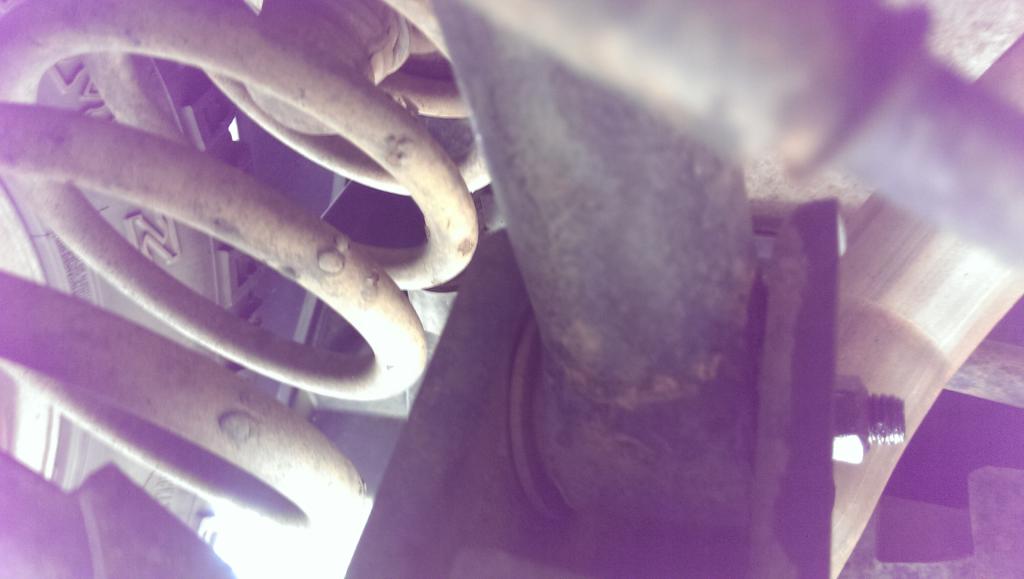

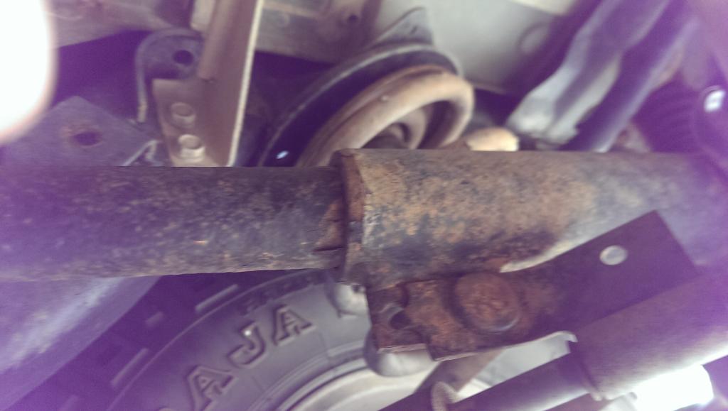

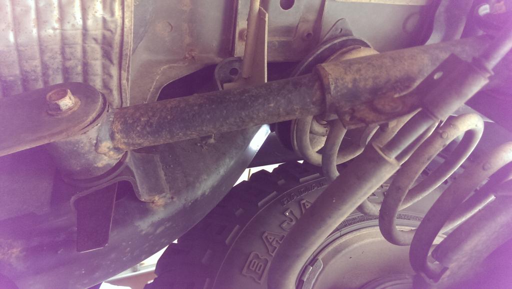

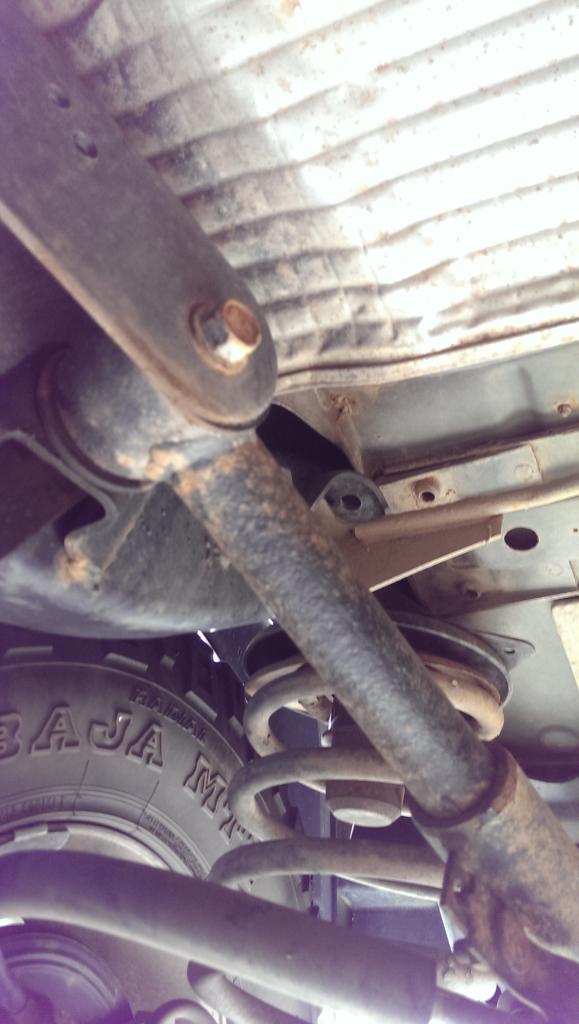

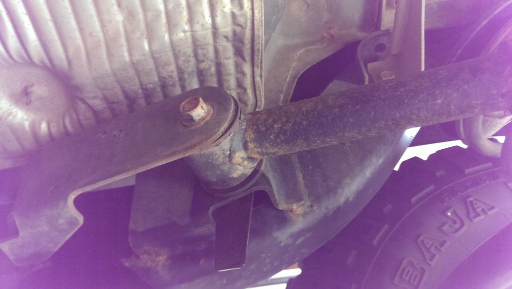

ID these TJ control arms?
cj777
Mar 22, 2005
Durham, NC
A friend of mine needs new bushings and is trying to identify who makes his upper control arms so that he can buy the right bushing. They're a pretty unique design since they don't have the normal jam nut adjustment. Anyone recognize this style?
My Teraflex ones are pretty similar, though the parking brake cable mount is a little different.
Thanks! Any ideas where to source a bushing that will work with them? It looks like Teraflex is out of stock
Probably just get YJ spring bushings from AutoZone.
'nother vote for Teraflex. look a lot like the ones on my TJ
might even be stock TJ bushings!
Definitely not stock TJ. The Teraflex ones are two pieces that are symmetric (one on each side of the joint) and have about a 1-1/2"ish OD and 3/4" ID, and a separate metal sleeve that goes through both.
6 or 7 years ago a 4" Rough Country lift I installed on my TJ had those type of 2 piece arms. I think i have a build thread some on here showing them.
