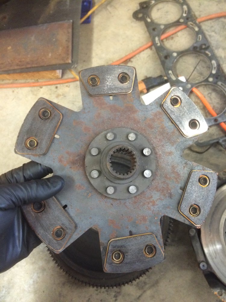

Can anyone identify this disc? It was behind a 22rte.
An unsprung 6 puck on a 22RTE? That's at least an order of magnitude more clutch than that engine needs, and all of the unnecessary harsh engagement of an unsprung too..
It's like brand new but I was a little nervous to run it so I just got a replacement disc from LCE.....not the cheapest option.
I don't think it's probably a Centerforce, Comp Clutch, ACT, etc., else it would have markings or stamps on it. If it's completely free of any markings, logos, etc., it's probably an offshore clutch marketed under lots of different eBay brands.
I'd still ditch the unsprung for a sprung hub. Your transmission will thank you.
My transmissions hate me, but a R151 can put up with a stupid amount of abuse. A springless clutch included.
I had the clutch pictured in a different turbo truck I bought with it already installed. It had no problem burning the tires off through 3rd gear.
