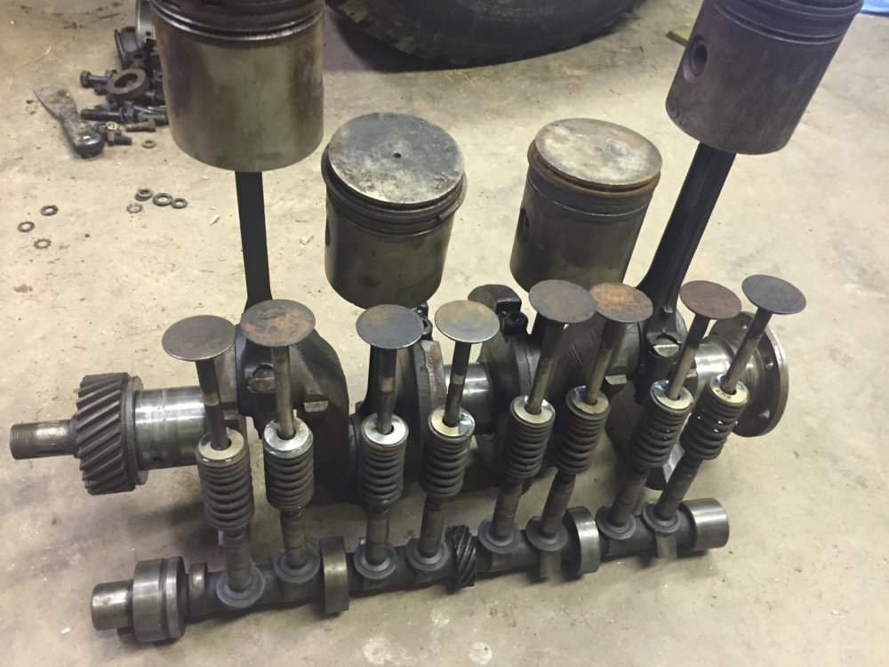

This is where Im at now. I welded washers on the springs to simulate compression so that the tops are all in line when the lobes are engaged with the tappets. I love the patina. Gonna start mating the two such that the elevation of the valvetrain is correct. all in all I really dig it. I just put a sleeve of paper under the bearing caps of the con rods to hold them still.
You could use the timing chain (but welded solid) to support the front end.
That's a gear-drive camshaft. Only the earliest ones were chain-drive. At the correct gear mesh it would still sit lop-sided.
its not a metal gear on the cam side. its fibrous or something weird. its very soft
either way, I still think its real cool - it was going to end up as rebar, so this is much better fate. a couple kids in the neighborhood now know what 4 strokes means. its cool the way I have it setup, you can see every stroke happening.
