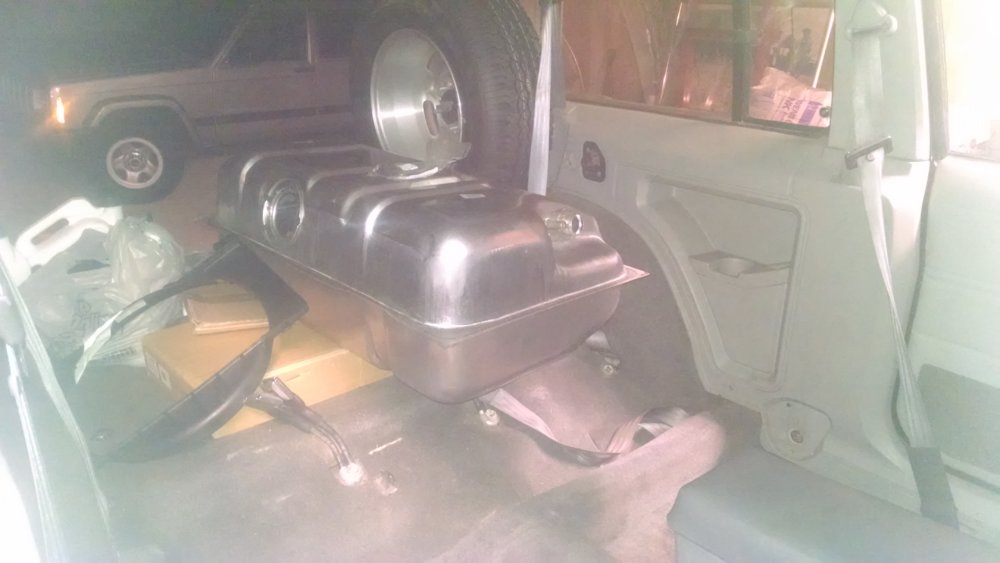

can you not swap the 97 and up tank in ? I think you have one;)

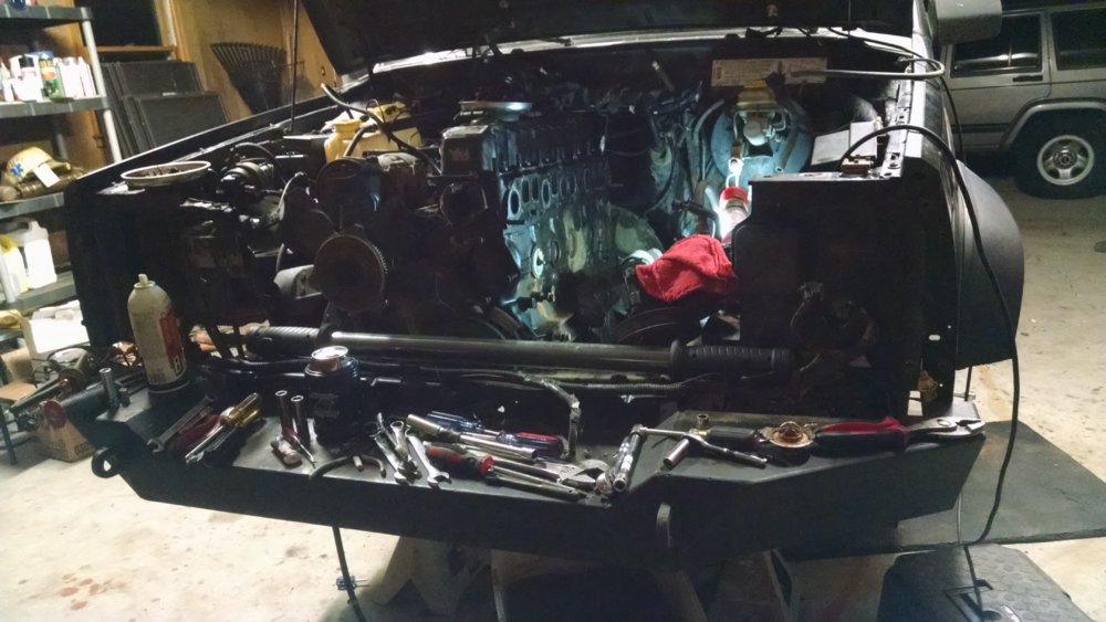

I do, thanks! There is some wiring mods that need to be done and the gauge won't read from 96-97. Also, I like the ability to change the fuel pump without dropping the tank. I have one on the way now so we'll see if it fits. I'm working on making this thing mechanically top notch and drive the hell out of it. I've bought a new gas tank, header, radiator, water pump and some new a/c part l parts so far. Think I want to finish it off with a decent sanding off of the paint on the hard corners and shoot a matte clear coat over it for the rat rod look.
Then it's off to find a new rear axel...
