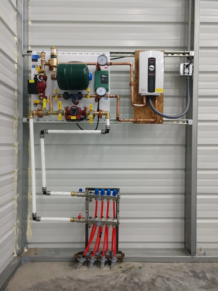

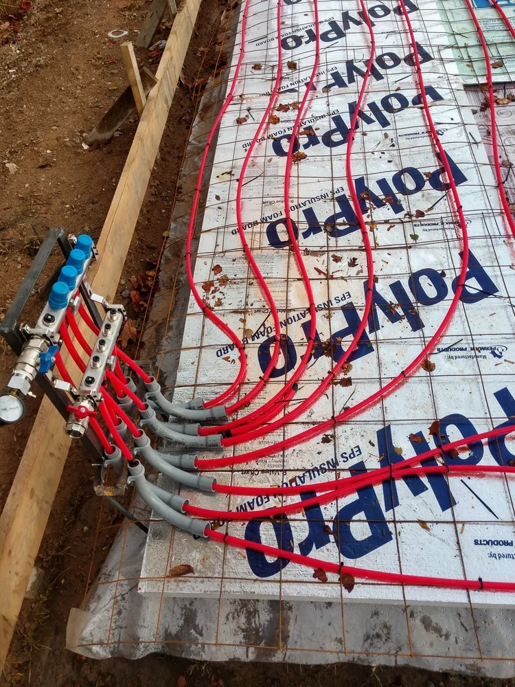

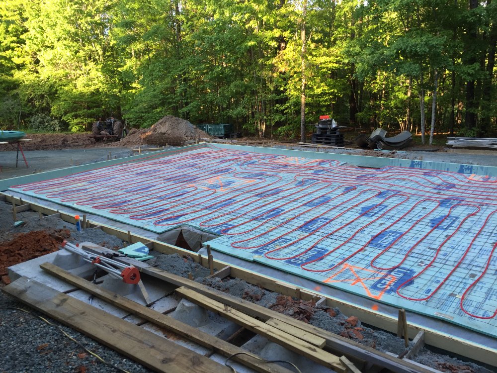

I have a 28x40 shop with radiant heat and would not consider another without it. Built about 6 years ago, installed myself for about 2.5k for everything. I did a hybrid insulation with a heat sink in the center. Keeps shop nice and comfortable. Building itself is insulated well. Happy to share any info.
