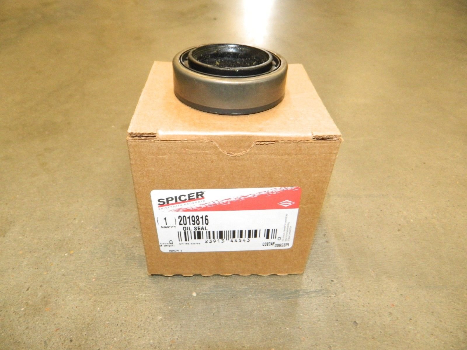

What’s the preferred inner seal to use on a D60? The seals on my 95 F350 are leaking so I figured I’d tear into it. Are the stock spicer seals the way to go?
Ended up finding out that there is an updated seal from Spicer, PN 2019816. Fit right in my Dana 60, no grinding or anything.
