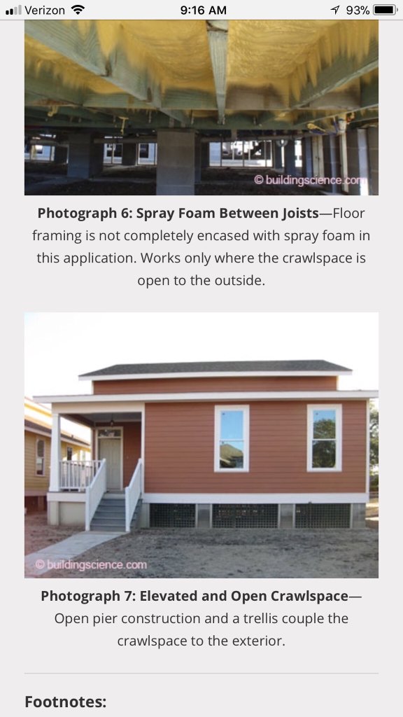

If it is built on piers with no continuous foundation wall,
Is there ductwork for the first floor in the crawlspace?
If no ductwork in crawlspace,
The best will be to spray foam the floor and floor joists.
Next would be rigid foam board with joints taped and sealed on the bottom of the joists. Foil facing downward 2” polyiso would be great for this.
Could also use two layers of 1” with all joints taped and staggered.
And you could fill lower portion of cavity with fiberglass during insulation leaving Air space at the floor.
If it is built like this with open piers, the crawlspace vapor barrier is not necessary, especially when the vapor barrier (foil faced poly iso) is placed on the bottom of the floor system.
Check out this link. BSI-009: New Light In Crawlspaces
If there is ductwork in the crawlspace, that changes everything.
I would certainly address the no vapor barrier in the very near future. Go with something white, you’ll be glad you did working under there in the future.
