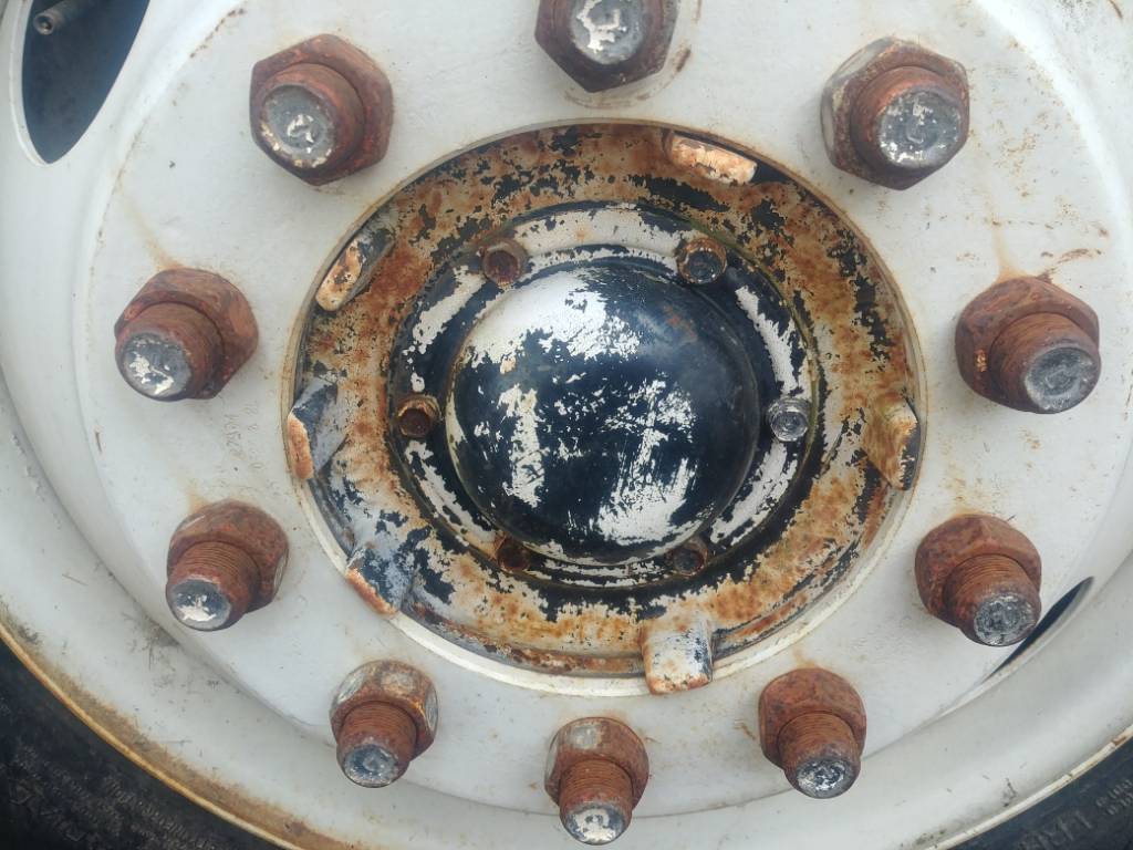

So I been looking at using mrap rims on my 4700. Not sure yet if the mrap rims are stud pilot or hub. Here is a pic of my current hubs. Are they a mix of stud piloted rims with a hub piloted hub?

With the square studs on the rears, they're budd wheels which are stud piloted. Hub piloted rims would have flat lug nuts like a Super Duty.
If I'm not mistaken, the left hand side is left hand thread and the right side is right hand thread.
That's definitely a uni-mount/hub centric.

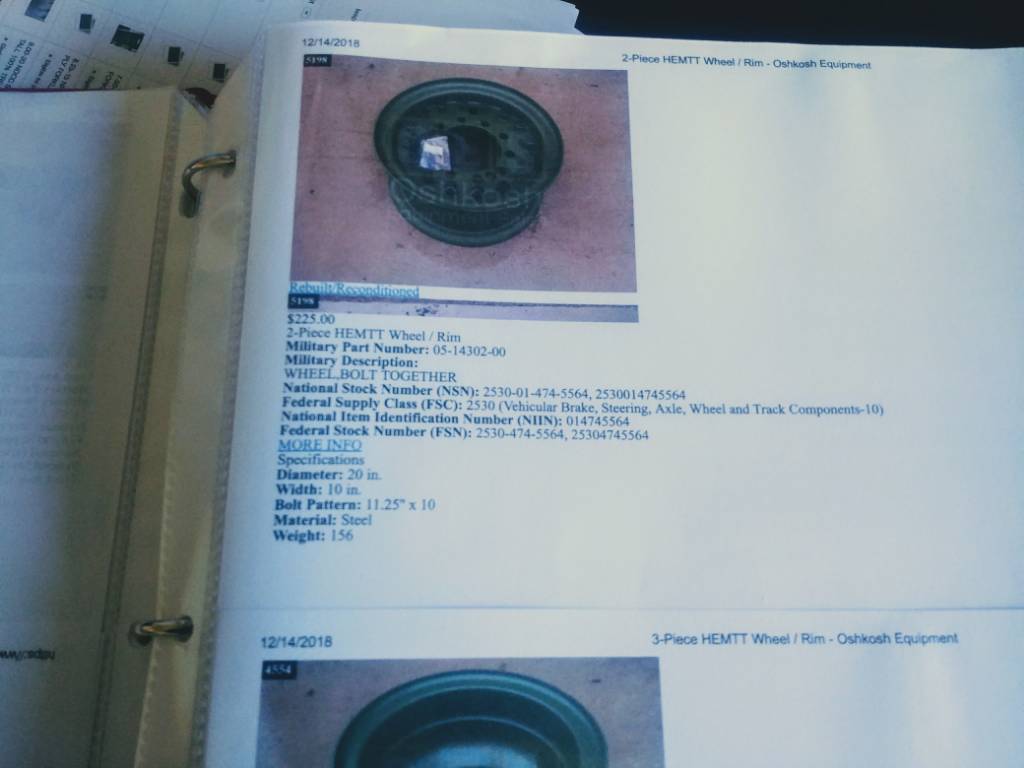

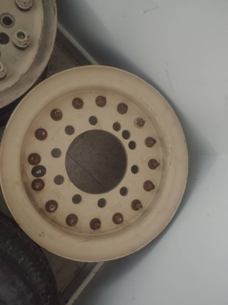

Went to a place near Bragg today that sells mrap and hemtt rims. Pretty sure the hemtt are the ones I need. The mrap center hole was 11 inches. The hemtt was the same as my semi rims. Plus the hemtt rims have some chamfer already.

You will NOT want MRAP wheels, they are aluminum which is nice but have a different lug pattern entirely.
The rims pictured in the first pic you posted appear to be LMTV or 5-ton wheels (pretty much the same). They are BUDD/lug centric wheels and should not be used with the lug nuts pictured.
The HEMTT wheels have a different offset and will make the tires stick out further on the front, and sit in further on the rear. They are more expensive as well normally.

It is actually not, they just used the wrong lug nuts for the wheel pictured haha.
The hub in the picture is what I was talking about.
