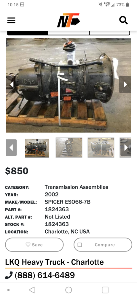

Link to the listing
SPICER ESO66-7B Transmission Assemblies For Sale Charlotte NC LKQ Heavy Truck - Charlotte - 7221689

Thanks so much! Going to call Kings and Bays today. And see prices if their more I will buy the LKQ one. Thanks again guys.

Kings doesn't have one if he did $950. Wish he did.
Bays doesn't have one if he did $1700. With a core. And I don't have a core.
And the LKQ one needs rebuilt good for core only. They have rebuilt ones for $3500 not counting core charge!WOW
So still looking. Probably need to buy the LKQ core and try rebuilding it myself?
