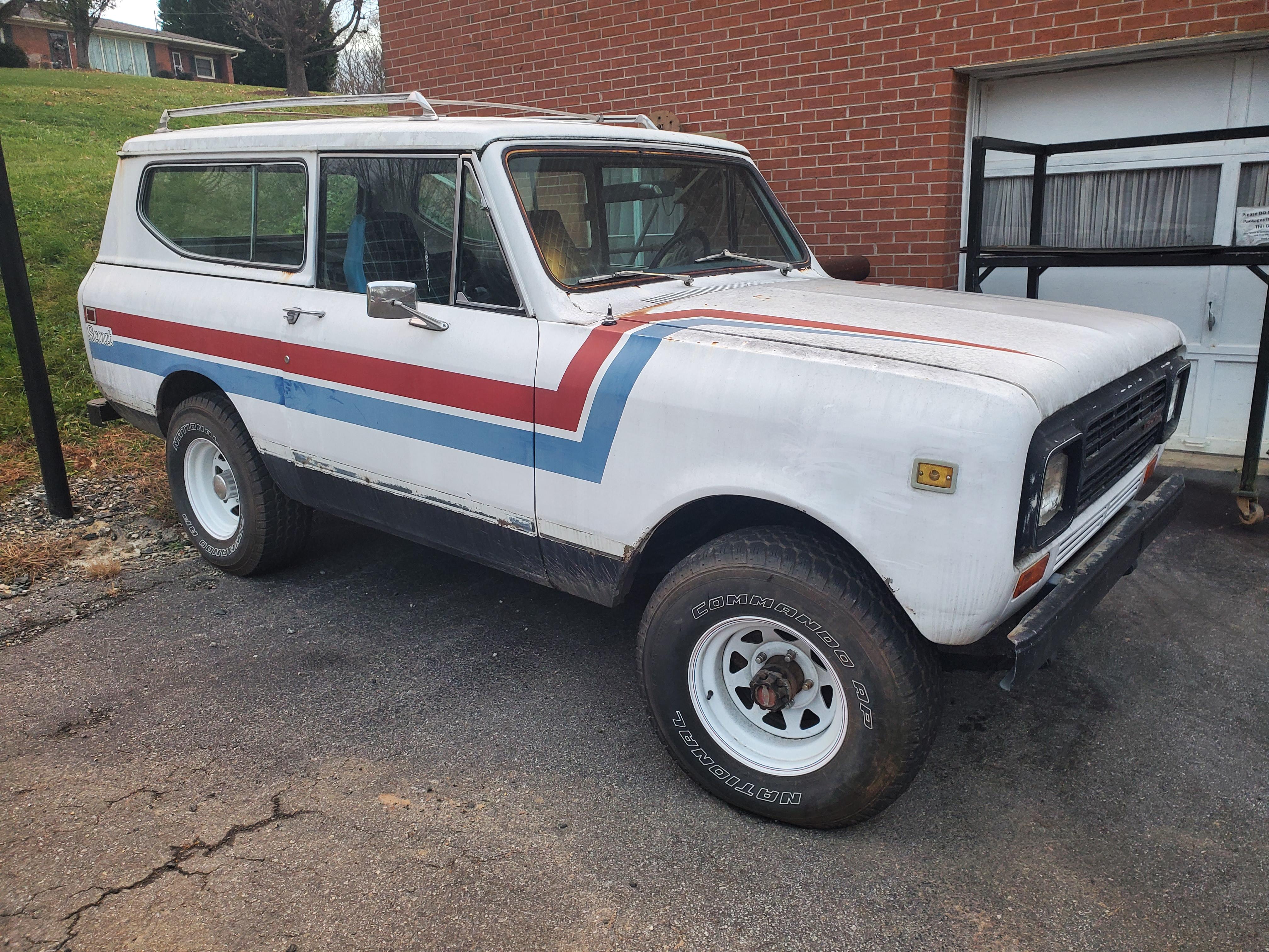

Looks like I just became a scout guy. Just got this one. 1980 345 auto, factory A/C and cruise. Never been around one until now. My dad used to have one in the 70s but I'm not sure if it was an 800 or a Scout II. I'm still trying to decide what I want to do with it.

Whoa!! That’s a nice scout. Not a bicentennial but looks similar. It’s a scout 2 and most likely since it’s an 80 has the Dana 300 instead of the older style cases.

Thank you. And thanks for the info. It's been painted once and they went for the 1976 look. The stripes are painted on. I haven't checked the t-case yet but I'm hoping it's a 300. It's pretty solid but it definitely needs a tailgate and floor pans. I'll look into the event in January. I'd like to take it down there. Do you still have yours?

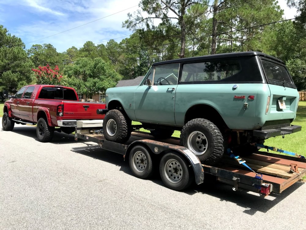

Come to find out my 71 has a swapped IH 392 in it! The line set ticket says it had a 304 and manual to begin with but somewhere between Arkansas and Georgia it got swapped to the 6.4 and 727.
I found a disc 30 geared 3.73 which matches what I got and haven’t put it in yet.

Here’s a few pics. https://photos.app.goo.gl/wv67mL13BfgCpy1VA
