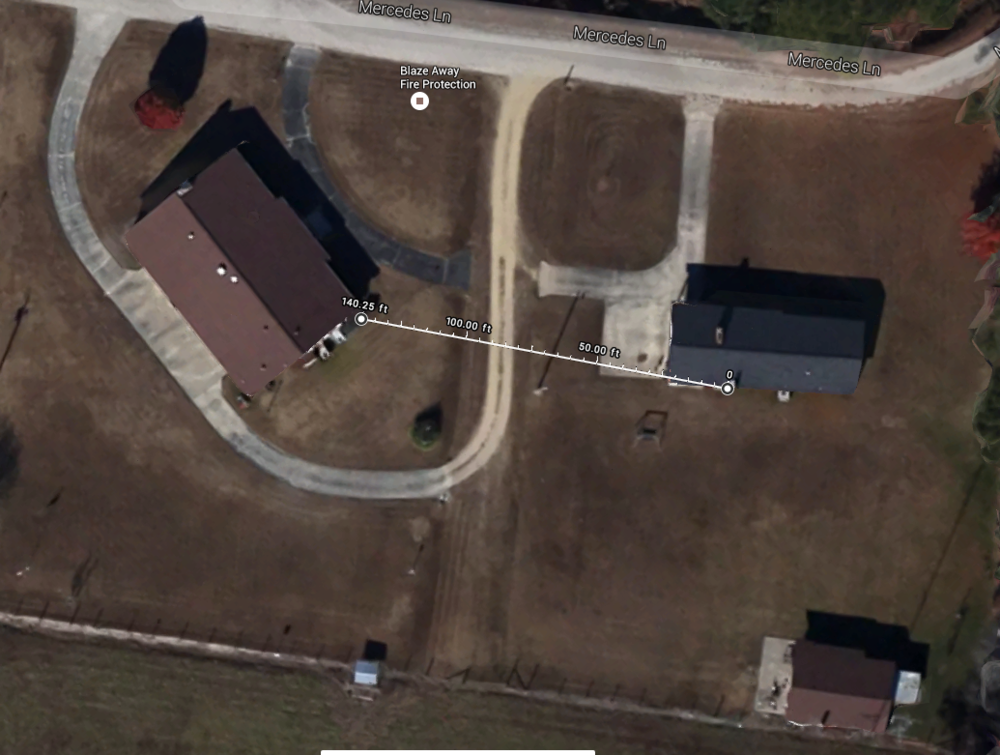

There are a lot of you guys on here that are IT so I figured I'd give it a go in here.
I need hardware/software recommendations for LAN/Wifi
My In-Laws live in the house on the left.
They have time warner cable
We Live in the house on the right cannot get TWC
We currently can get wifi at our house from their house but it's spotty.
I would like to run a ethernet cable to our house and maybe to my shop. Bottom Right
What would I need?

Water line runs in-between the houses down the dirt road so that may be a fun obstacle

Wi-Fi is in range for my laptop but not for mobile devices. It looks like I am within the 100 yard cat five requirement.
Direct burial CAT6 in a PVC tube ran off ran from one of the ports on your router from the main house to the other house. Get a router and turn off the DHCP when you connect it to the other end, change the IP address of the router so they don't collide. The other network gets its own wifi setup and piggy back's off the main setup. Basically look up using a router as an access point.
