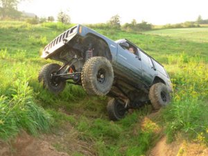

Thanks to everyone for all the comments and support. I've now got an Aussie for the front axle on the way (compliments of cj777) and also picked up a pinion guard (for the 9") from Scott @ MudPro.:bounce2:
So hopefully we'll get these items added soon and have a few more photos up. I might post some video up, just depends on how much time is available this coming week
Few updates...
So far, everything is holding together (knock on wood)
well...the MTR's didn't last too long - we put a root through a sidewall, and completely ruined that tire :gay:
But, I scored a deal with a friend and landed a set of pretty good shape 38" TSL's and absolutely love them.
I ran the stock shafts with 760's tack welded in for a few weeks, but it was time to upgrade. To cope with the extra tire size, as well as one that actually gets traction, a set of Yukon 4340's and super-joints were added to the front 44. Hoping this will hold the 44 together with the 38's.
Got sick of the axle hop commonly and rightly associated with the radius arm and y-link design, so we added some Rancho 9000 XL's from Brandon at Rides to dampen the problem. It ended up fixing the problem entirely as far as I'm concerned.
After crushing in a good percentage of the passenger side rocker panel, we also decided to attach some LB engineering rocker guards.
We're getting ready to assemble some bead-locks this week from Ballistic Fabrication, so I'll try to post some shots as the work progresses on those.
