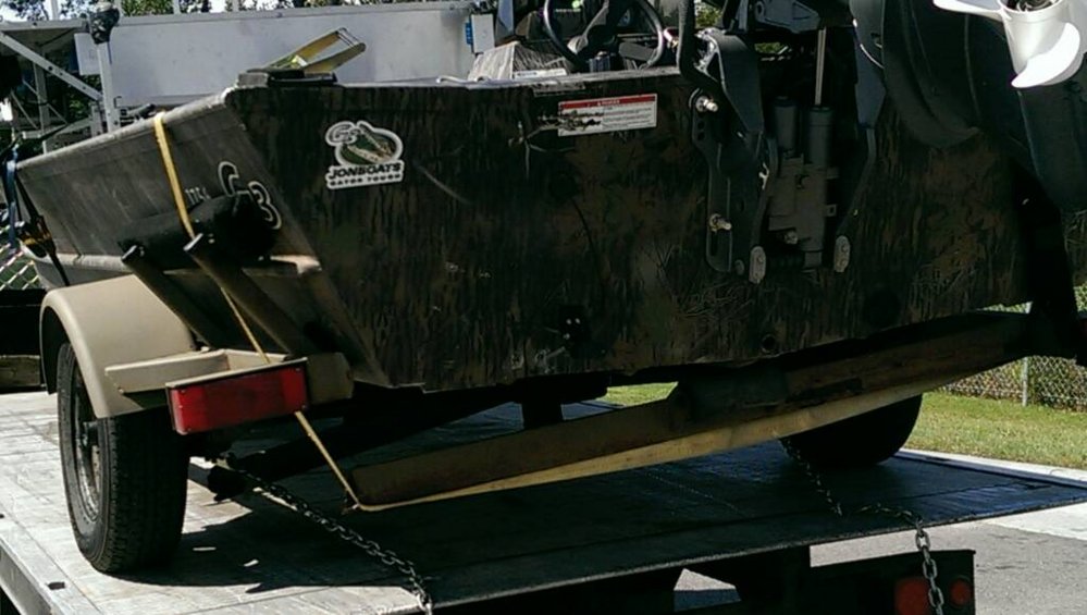

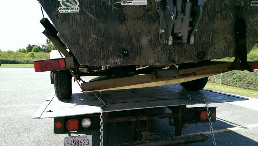

On our way home from scouting gators, when this happened...

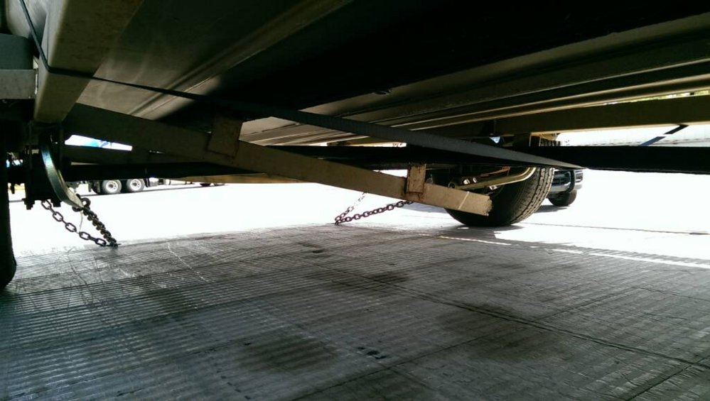

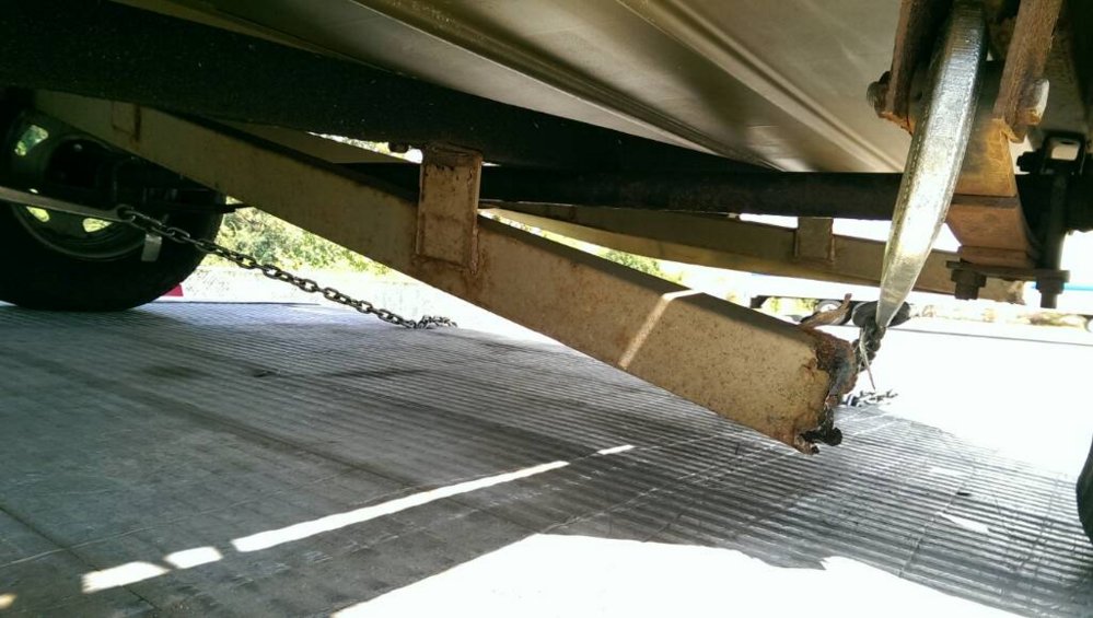

All three cross beams broke. Almost dropping the boat into the middle of I-95.....
.... hahaha yep.... Its funny b/c I was just telling my buddy his trailer was looking a lil rusty...... guess it was alot rusty

I'll pass on that info! I know he just replaced that one, hit something in the water one night and shattered the last one. He's having it towed to his house for now, then gotta figure where to store the boat so I can weld in new cross braces. "IF" the side rails aren't rotten too...
