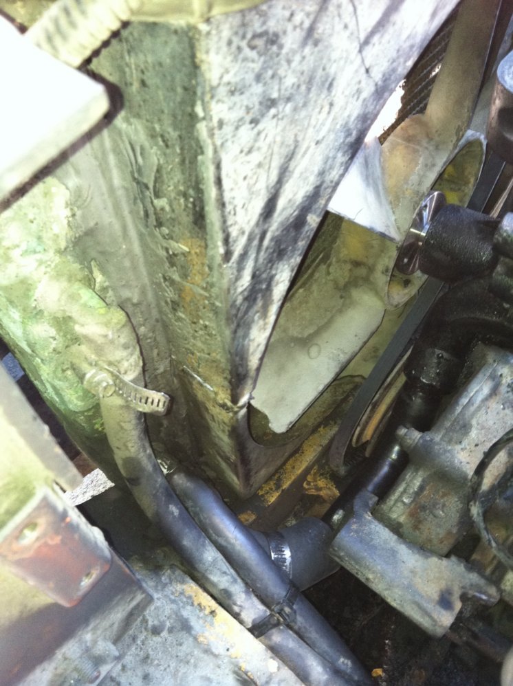

It's like liquid duct tape, but better, can be used effectively to seal a cracked or weeping tank on a radiator, and will last a long time.
Keep in mind, where ever you apply said JB Weld, it's gonna stick, and stick well, and hold together anything else it gets on.
When applying to radiator, refrain from also coatin fan shroud and lower radiator hose as those parts may need to be removed some day (today).
The extra 45 min to remove the fan from water pump because shroud could NOT. Be removed are direct bill hours, the 15 min to remove lower hose, yes, that's billable too
Keep in mind, the $1200 radiator replacement is inevitable if you plan to keep (and use) the machine for any length of time.
Oh, and remember, I still have to install fan after water pump replacement, should be done by end of day.
This has been a public service announcement.
/Rant

Water pump finally mounted, going after the fan now, this is gonna be fun:handed:
Yes. As frustration level grows, so do " time outs"
Ahhh the life of a lift truck technician, aint it just wonderfull!
the best part.... I get to do it all again !
the new water pump is leaking from the rear plate, not something I had messed with other than checking tightness of the bolts. N serial numbered Yale, I think it's a Mazda engine. one huge casting with lower hose tube welded to bottom, of course it's not in the correct position, I had to dent the tube to clear front cover bolts :rolleyes:
This fucking thing was fighting tooth and nail, went to put the fan and pulley ( w/spacer) back on, new flange is threaded 1.25, old is 1.50, fortunately I have Toyota bolts on my van, cut to length and done. I don't generally fuss about what I'm working on, the JB Weld pissed me off, and the idiot that did it was all proud of himself:flipoff: ( apparently done in the last 3 weeks )
second time is a charm I guess. :poop:

Can you not condemn the jb weld and some kind of deterioration, unworkable BS and make them replace the shroud?
I can't make them repair anything, I can't lock it out without authorization from owner, just highly recommend in writing that machine should be removed from service and get a signature by owner
if it were one of our rental or leased machines, totally different story.

What about just saying . Sorry I cant remove the water pump without destroying the fan shroud. SOmeone JB welded the fan shroud to the radiator, when I pull it apart its probably going to break and need to be replaced.
I didnt say that right...
Yeah, I could have done that, and if it had been a particularly troublesome customer probably would have. I tend to try a little to hard to make things happen, get things done that others would pass over. Sometime it kicks me in the ass, other times I usually get more work or at least an "attaboy" :huggy:
