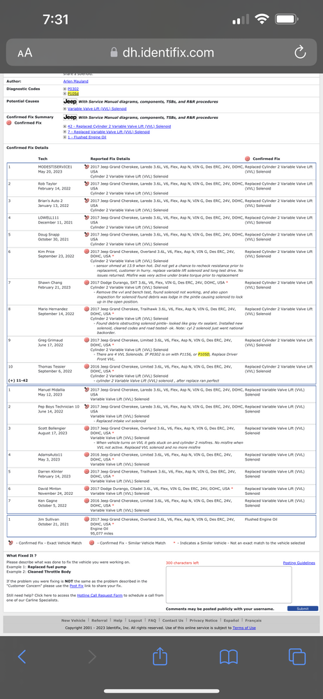

Coming home today, it was idling rough at stop lights. Check Engine Light came on.
Code P105D.
My Google skills tell me it is a VVT solenoid sticking. I think there should be two, one on each side, but don’t know how to tell which one is bad.
