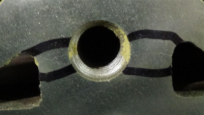

Got my block to the machine shop over the weekend. Machinist called me today and had found two small hairline cracks around a head bolt hole. Has anyone seen this. He said it's pretty common in some of the late model blocks. Thoughts anyone. What sucks is I took it to another shop in Burlington and had it baked cleaned and magnafluxed. Guy in Burlington didn't catch it.
He said it goes a couple of threads down on one side only. Anyone here with a bit of 4.0 machining experience?
Ok I think I have a plan to fix. Time sert with head studs. Now does anyone have a 1/2 13 time sert kit I can borrow. Willing to give a deposit equal to the cost of the kit.
