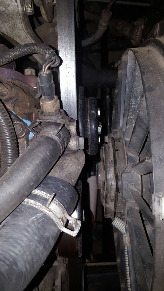

Just to give you an idea, this is a pic of my volvo fan on a yj 4.0. I trimed the stock shroud way down. You could gain about 1/2" to 1" by offsetting it a little more. I haven't wheeled it in these hot summer months yet but it does great in stop and go traffic. The high speed kicks in and the temps drop instantly.
Sent from my SM-G920V using Tapatalk
That just confirms that it probably won't fit.
My motor is a good 1.5-2 inches forward from stock.
