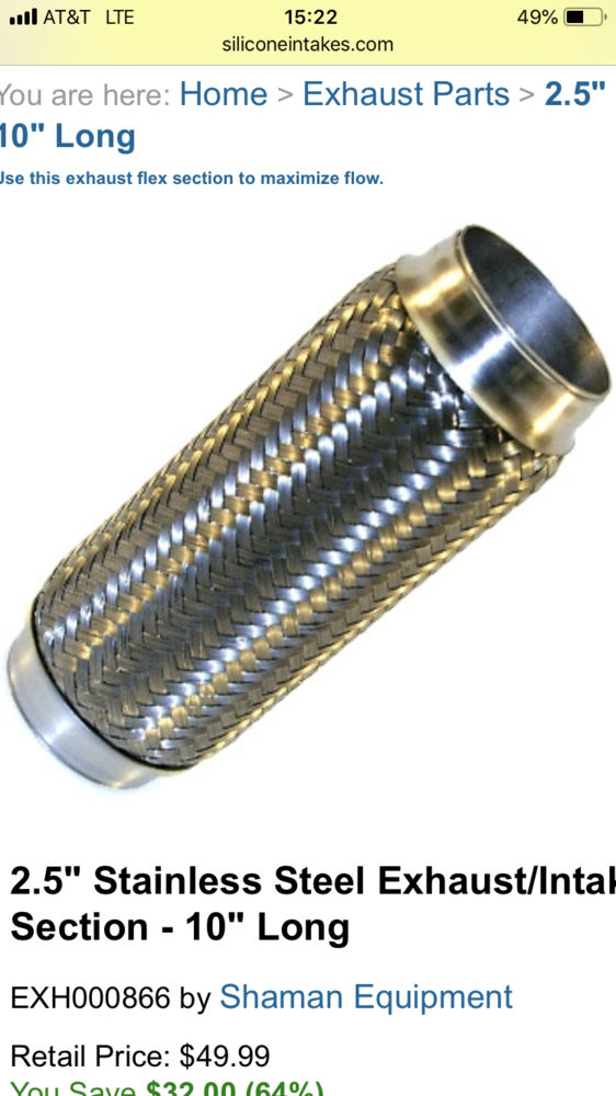

I need to weld in a piece of flex in mine.
A buddy used one of these right after it makes the turn and goes past the Tcase. He also had real good luck making it last.
much cheaper at vatozone. I'll probably place mine at the turn behind the engine.
And most of the time the brace just past the flange at the bell housing is missing/broken. I've welded about a dozen this year. I've had good luck with welding them. Of course, I have seen a few come in already welded & cracked also. Adding a flex section is the best solution. I'd put it in the straight section under the bell housing if it were mine. Just seems to make the most sense.
