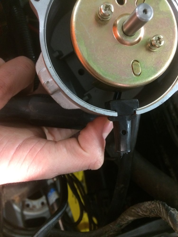

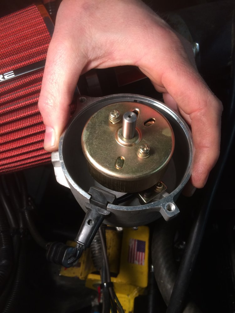

Scott the distributor is new and the old one was tried also so I doubt its that.
His distributor doesn't look like the ones in videos that describe doing what you posted Jody. We set it again after his posting making it the 4th or 5th time it's been done. Still nothing.

It's weird the dizzy doesn't have a hole to align. The sweet spot for #1 is right at 5 oclock if you wanna do a stab and go.
