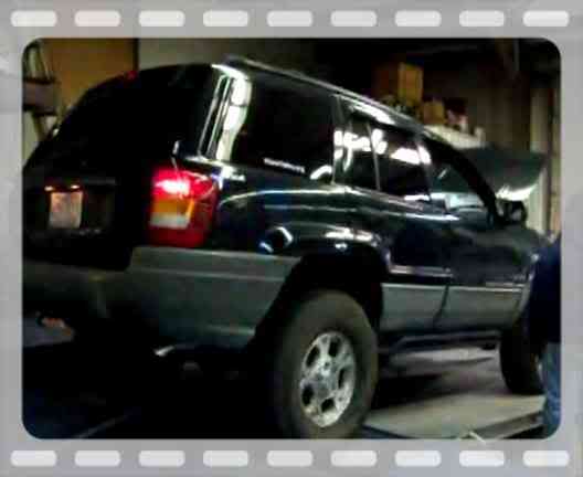

I'm going back to the exhaust shop next week to have them complete the installation and bring the pipe all the way out the back. By then I'll have ~ 1k on the engine, so its time for the dyno test!

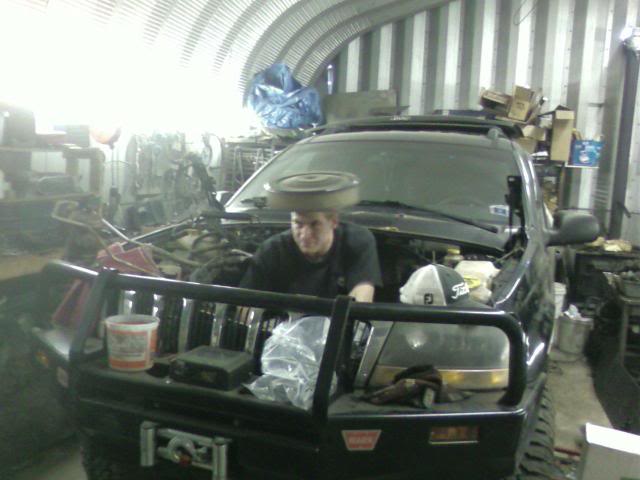

I had to tear back into it at the end of 2013.
Here's a cut and paste from my Jeepforum build thread.
Ended up tearing deeper into the engine than originally planned. Going to be basically doing a full rebuild on it again. The block, crank, and rods all needed work at the machine shop. Cut .035" off of the top of the block to take quench height down to ~ .050" with the Victor Reniz MLS head gasket. That should increase the compression for more power and run better with the better quench #. The compression calc on jeepstrokers.com is estimating 9.4 static and 8.1 dynamic compression ratio. Which is up from 8.8/7.6 CR before decking the block.
Machinist reconditioned the rods, said they needed a lot of work. Probably my fault for going with the cheapest I could find the first go around. Crank was turned to .040/.020 to clean it up.
Specs on the engine ended up:
4.5L Simple Stroker
* 4.2L crank & rods
* H802CP pistons (18cc dish)
* 9.57:1 SCR / 8.28:1 DCR
* Block decked 0.035"
* Victor Reniz MLS Head Gasket
* 0.050" Quench
* Stock Injectors
* Ported Head
* 62mm TB
* 2.5" Magnaflow cat and Flowmaster 50
* JBA Header
Stock injectors are delivering plenty of fuel. AFR is steady at 14.7 for normal driving and drops to upper 11's/lower 12's at WOT.
It's been running great since.
