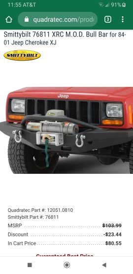

I'm leaning towards getting the smittybilt mod bumper and the bull bar. I will probably buy the bull bar separate down the road.

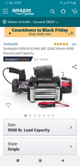

Then also getting a smittybilt winch 9.5k. I really want to run synthetic but trying to keep this under 800.
I'm trying to decide if this setup is reliable.
I know I'm probably going to need a new steering box spacer.

That's one reason why the smittybilt looks real good on quadratec or amazon.
Thank you for all of the links. That goliath came close but was still going to be 150 more than smittybilt. I'm going to hold out till black Friday and cyber Monday and see what comes up.
