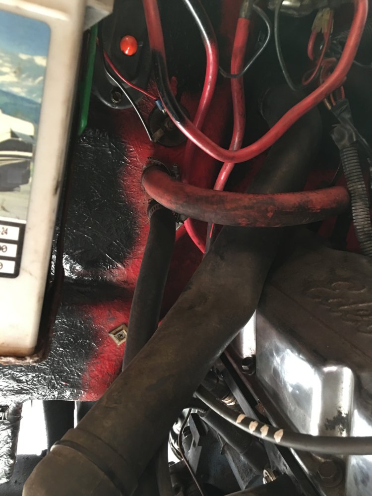

Thank you, I believe I saw that last night, but Im struggling with taking it all apart when I dont need it nor will I ever and just bypassing it or fit it now. I already know the whole heating unit, ducts and all, arent all there so there is my struggle to fix it, it will never be a show jeep and it will always be in the garage. Guess if I bypass the heating unit I was told to run a straight loop. Took a look under the hood by the battery holder, looks to be 2 hoses side by side right about where the core is. Looks like one goes to the water pump and the other to the back side, up top, on the engine block. Any clue if thats where I run a staight loop of hose, from thr block to the water pump? I have a pic if that will help.
Not a great pic but enough to see the 2 hoses side by side at the firewall. Black one goes to the water pump and the read ine to the back of the motor up top
Yep, that's it. Just yank/cut em off at the firewall, & couple together. Or plug both off. I don't know of any reason you Have to loop them. Plus their suppose to be different sizes, though some get away with using 1 size hose.
I've done emergency roadside heater core bypass, by looping the inlet back to the outlet. Worked fine, except it was winter, we were on our way to ski at snowshoe, and we froze our arses off.
