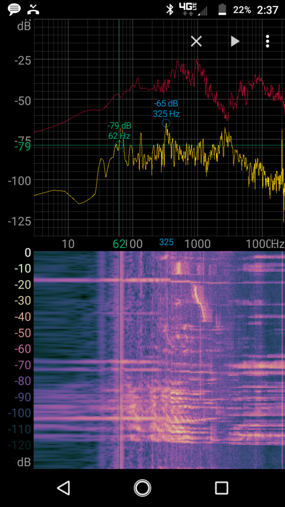

Put spectroid on your phone. Audio spectrum analyzer with peak and selectable identification of frequencies with a waterfall.
