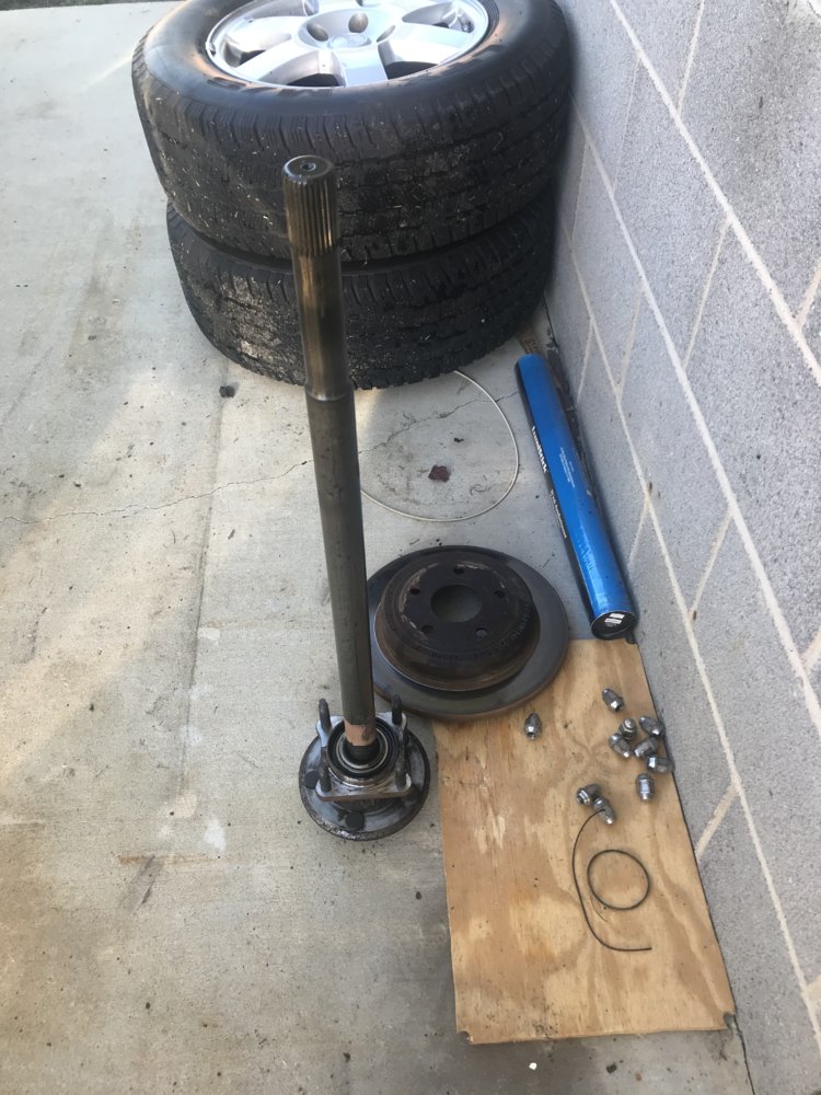

Well the new(used) axle is in. The noise is gone. I reused the wheel bearing and brakes from the axle I had. I go started fairly early Sunday and was done by 3 that afternoon.
I am going to take apart the old axle and see if I can determine where the noise is coming from.
